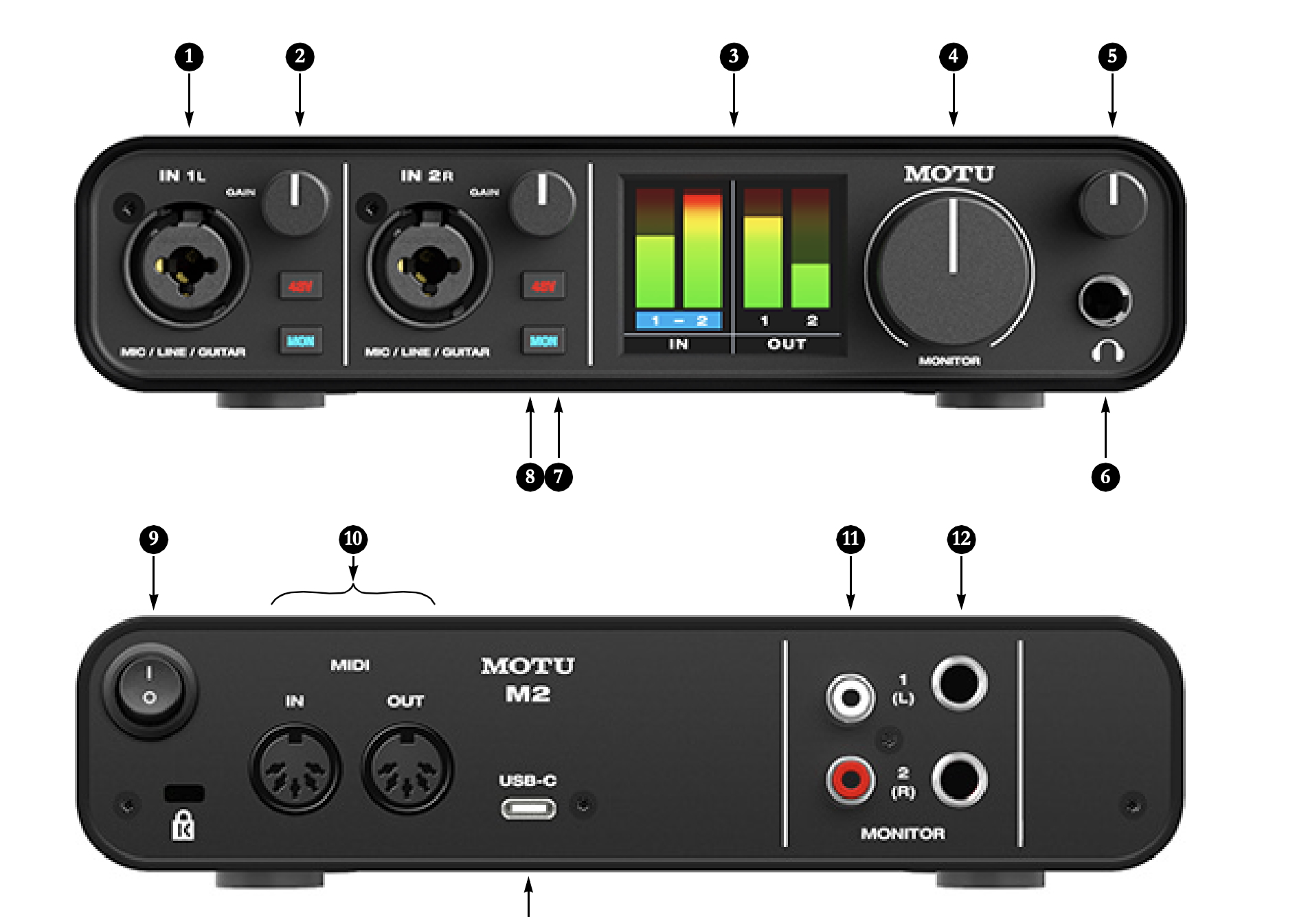

I'm not clear on what you are trying to do but those jacks on the back of the M2 (#12) are line level outputs only. They are designed to drive line level inputs in powered speakers and audio mixers and do not have enough signal level to drive standard audio inputs without a mixer, DI box or step-up transformer to boost the signal.Plugging the Y Cable 3.5mm Jack into the Feintech SW212 and connect the other end into the 2 backside 6.35mm Ports of the MOTU M2.

Re: No sound from my Switch 2 Console when connected to Motu M2 with Y Cable
So the outputs on 12 (the big ones, not small colored ones) are not meant for an external audio device (Laptop, Console, Phone, you name it) which then you can hear on your PC?
Correct. The M2 is designed to get analog audio into your PC via USB.
To get analog audio from the M2 into anything else, the destination must be able to boost the signal such as powered monitor speakers, the normal use.

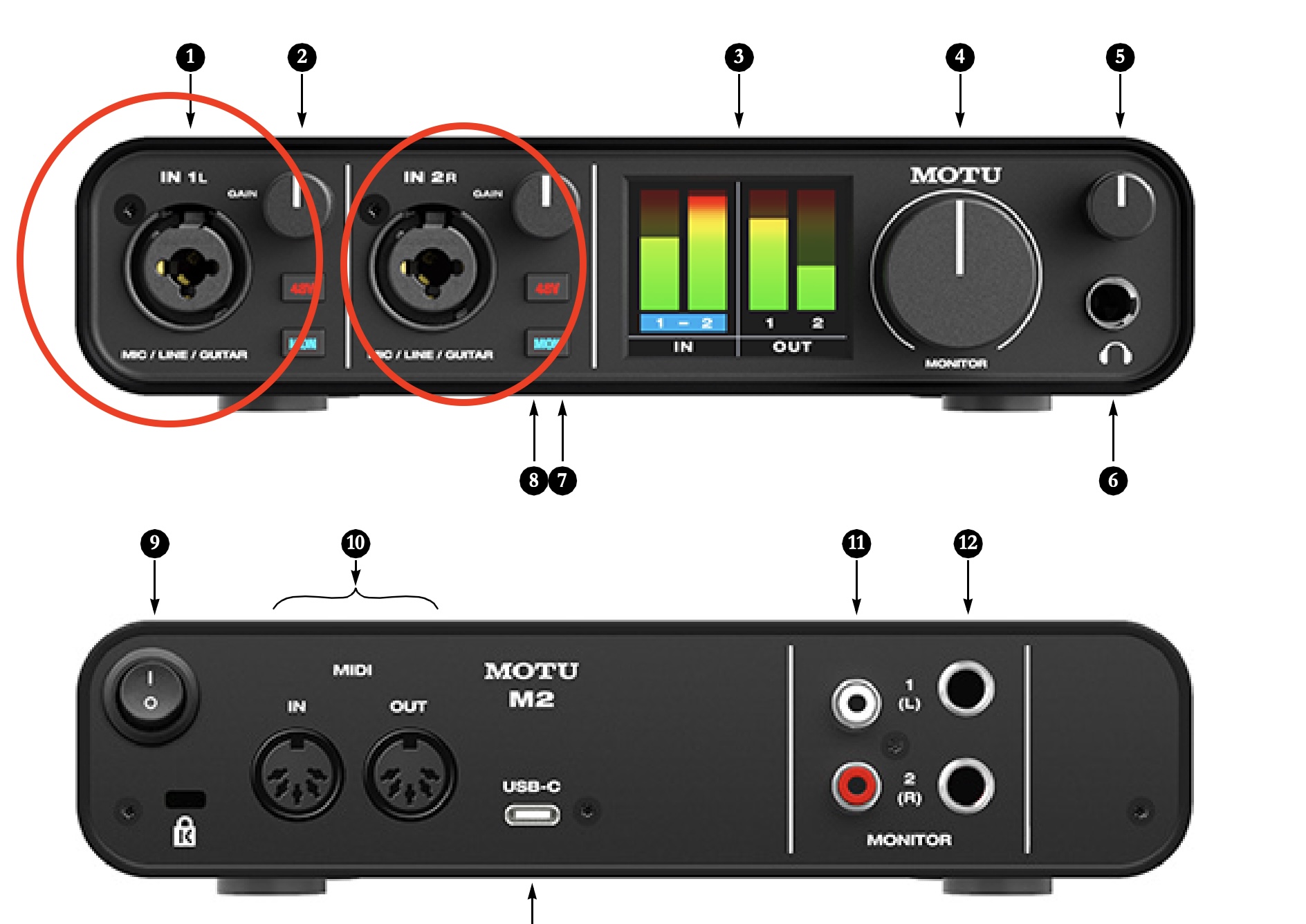

Yea the main goal (just to not have any misunderstanding) is to have audio through the motu on pc. Which is connected through USB. So my external device - my console or whatever audio device with 3.5mm jack port - sends it's audio to the motu interface with the Y cable (3.5mm end connected to the external device which I want to grab the audio from and the 2 mono 6.35mm ends connected to the bigger mono jacks on the backside of the moto). According to official specs / sheets this should be possible. In the end I wanted to send the audio from my external device through the motu into my PC. I'm not sure why all the sheets etc. said it's possible with a Y cable connected to the bigger back jacks.
- Posts: 16273
Your CombiJacks (#1 with the red circles) are the only way to get Audio In to an M2. The jacks on the back (#11, #12) are Audio Out only.Dustn wrote: ↑Thu Jun 12, 2025 4:16 pm Yea the main goal (just to not have any misunderstanding) is to have audio through the motu on pc. Which is connected through USB. So my external device - my console or whatever audio device with 3.5mm jack port - sends it's audio to the motu interface with the Y cable (3.5mm end connected to the external device which I want to grab the audio from and the 2 mono 6.35mm ends connected to the bigger mono jacks on the backside of the moto). According to official specs / sheets this should be possible. In the end I wanted to send the audio from my external device through the motu into my PC. I'm not sure why all the sheets etc. said it's possible with a Y cable connected to the bigger back jacks.
USB is two channels Audio Out from the M2 to your PC — the audio comes from those CombiJacks that I have circled. In addition, you have four channels Audio In from the PC including Loopback. What you hear at any given moment is determined by how you set the Monitor (#8) button.
I feel that I'm missing something and I'm certain that you are. If you could provide a simple signal flow diagram, that will help — a sketch is fine. You can upload up to three attachments in a post.
