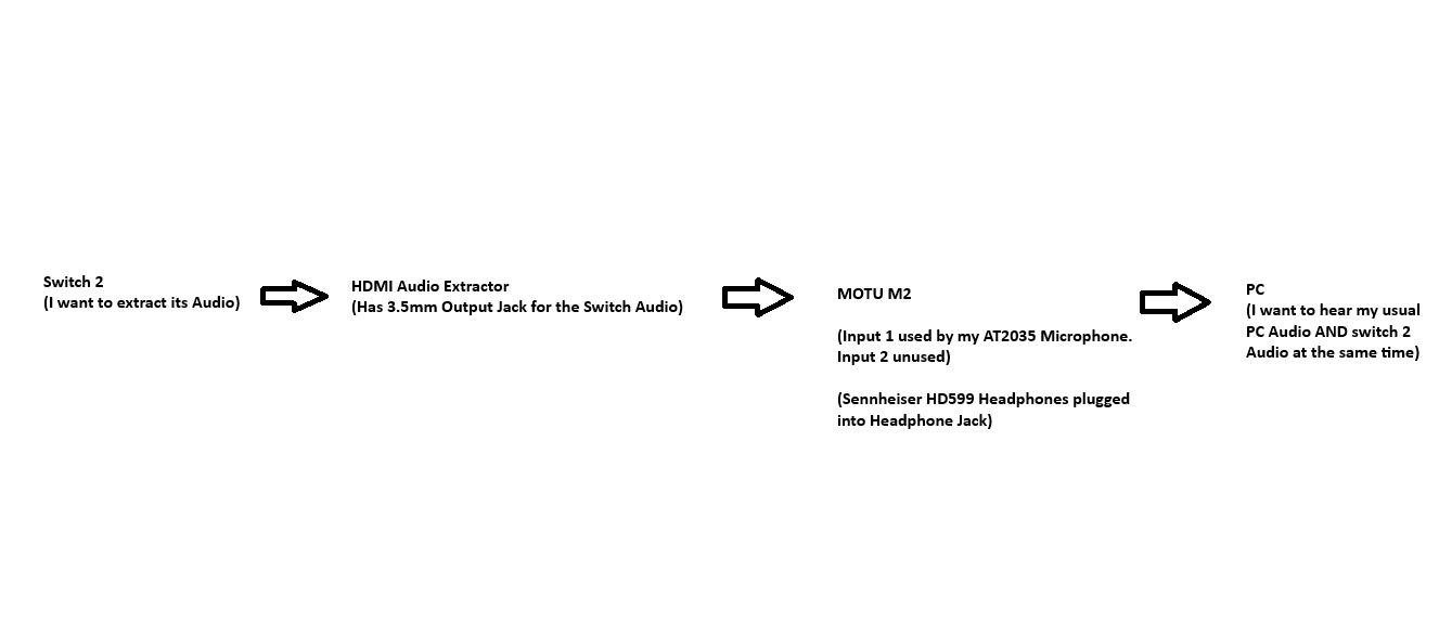

So the only way of getting my external device's audio into the MOTU m2 (which I need to hear in stereo in the end - through my HD599 Headphones on my PC) is by using the 2 front inputs. One is occupied by my microphone already though. So putting a mixer infront is the only solution?
Im really bad with graphics, but I tried my "want to do" as a graphic.
The HDMI Audio extractor, not sure if you are familiar with it, sends the Video Signal to my Monitor (which works already) and the audio signal through the 3.5mm Jack Output.
