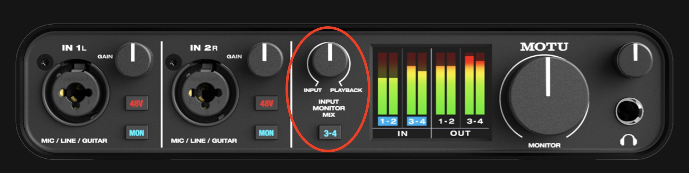

I haven't a clue about your driver question but, when you bring up sound quality, that might not be what is going on.
The closer you get to the 50/50 position of this control, the worse the sound will be in the monitors and headphones. There is no such thing as zero latency—a timing delay will always be present between analog Input (actually output over USB) and Playback (input over USB). This causes phase distortion, comb filtering and other artifacts. Unless you've caused a feedback loop (possible) your recorded sound is unaffected.

The User Guide has more info on how to set the Monitor buttons and functionality. There are options that are not intuitive found on page 8.

First of all, thank you for taking your time to try to help.
In my normal use, I haven't had to use the monitoring feature (at least not from the interface itself, though I understand its benefits and value), so I usually keep it all the way through playback. If i had to debug input, I'd definitely use the knob all the way to the left, but leaving it in the middle seems a bit more situational.
But it's nice to know the possible issues it could bring from using it!
My issue is more about understanding how I can better manipulate Loopback and Loopback Mix on Windows outputs, and how Windows/Realtek drivers affect those. Hopefully someone has some insight on that specific thing, I haven't checked if they have official support requests
