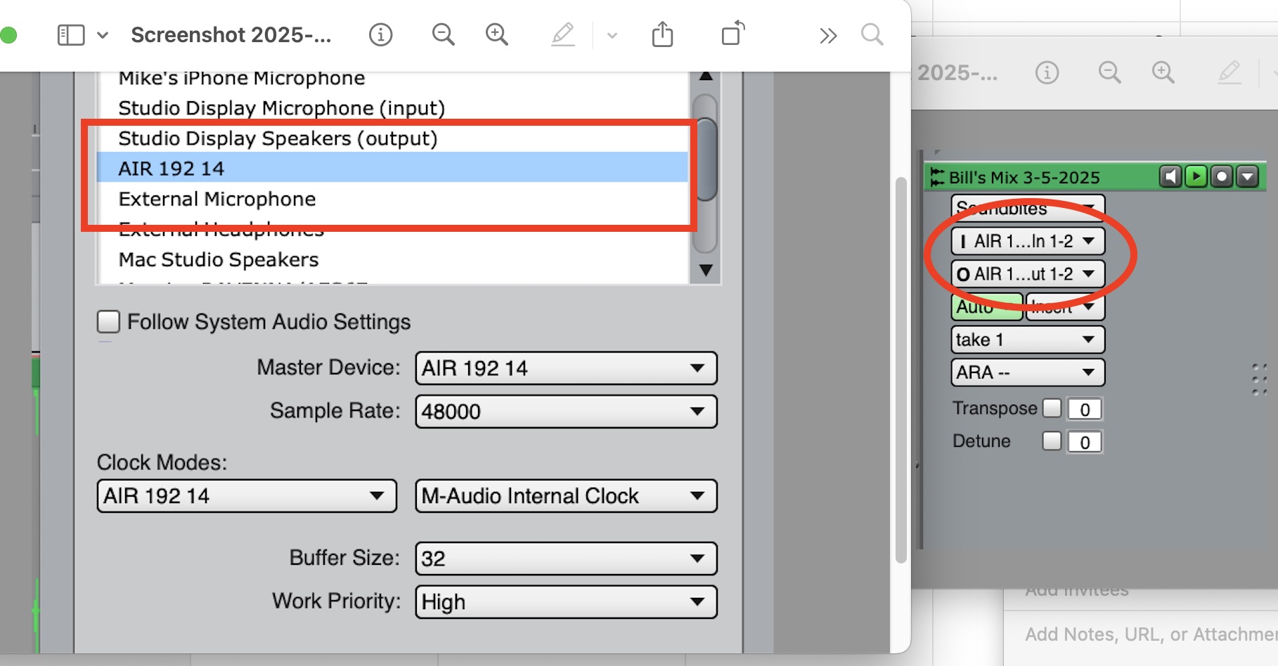

I'll play... Are your outputs set to the 6i6? Does DP have access to the Microphone?
Show us some screen shots
The 6i6 in Audio MIDI Setup.app
Setup/Configure Audio System/Configure Audio Driver
A chanel I and O settings
Below is a setup for my AIR 192|14. There are a number of ways to configure a track's output including Monitor, Aux etc. but at some point the signal has to be heard.
Screenshot 2025-03-29 at 9.57.11 AM.jpg (299.79 KiB) Viewed 1771 times
Screenshot 2025-03-29 at 9.52.57 AM.jpg (232.7 KiB) Viewed 1771 times
