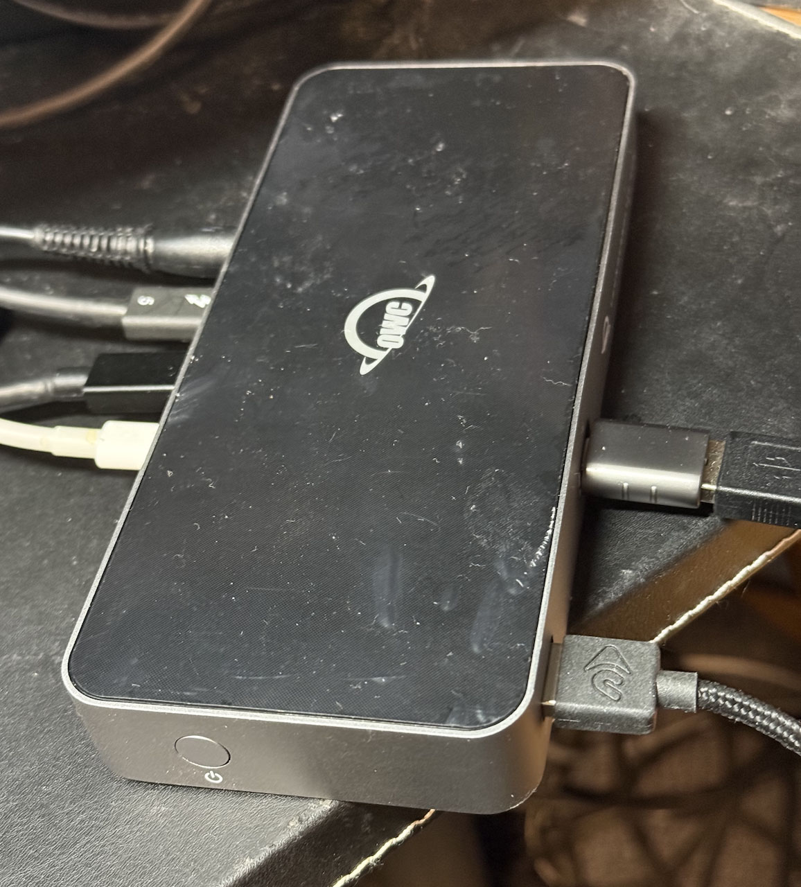

You may need adapters and/or cables depending on your uses. This picture shows my Apple TB2–TB3 adapter in white and a USB-A to USB-C adapter on the opposite side. The TB adapter has my 828mkII FW plugged into a TB2 dock. The USB-A adapter has my MTP AV USB at the other end. The USB-A port is charging my keyboard over a USB 2 to Lightning cable. The macOS does not support 2000MB/s (USB 3.2 gen2+2) except over TB5/4/3 (or TB2 with the Apple adapter).

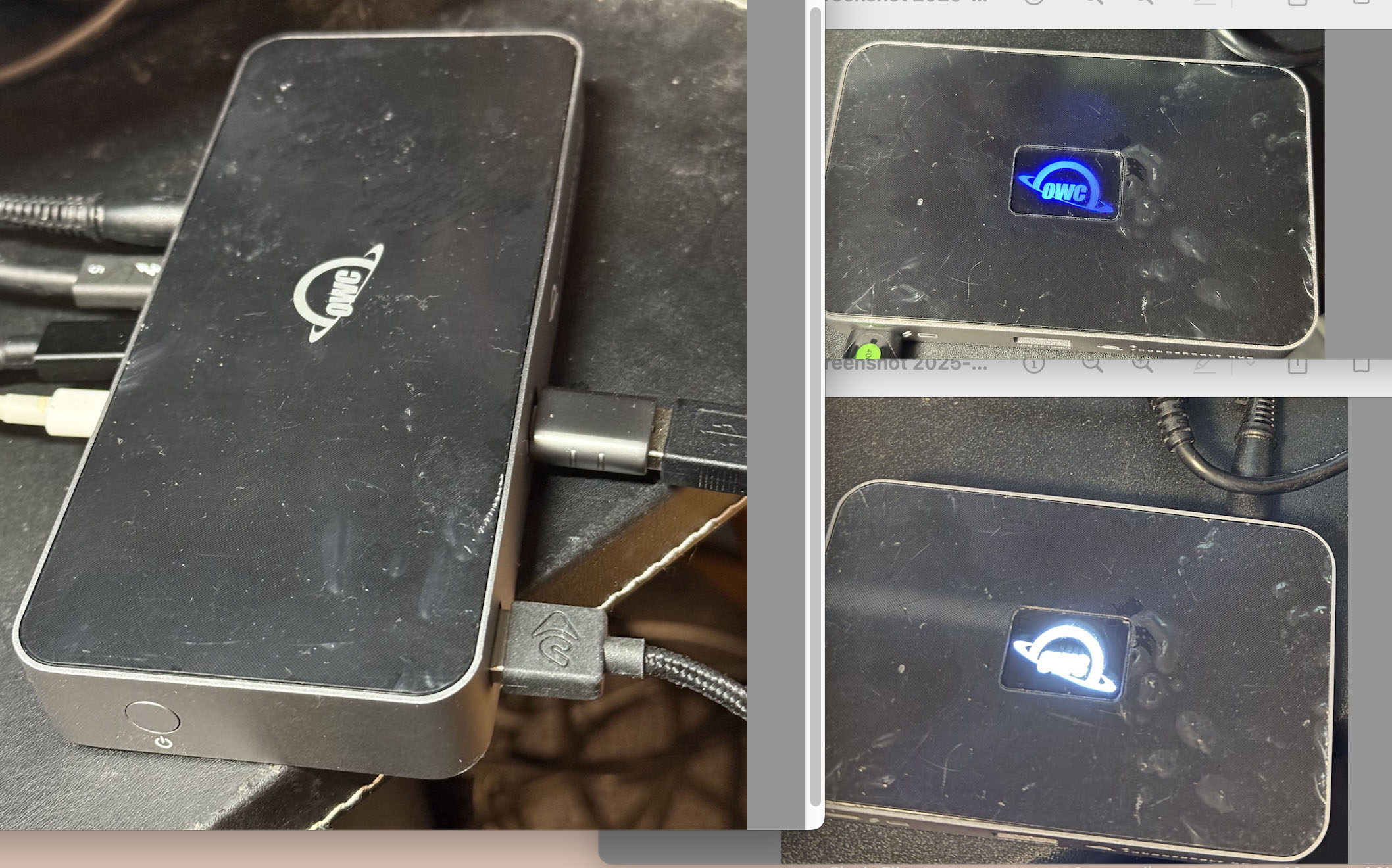

The TB4 hub has puts out 60W bus power and is limited to a theoretical 4000MB/s data + AV. Real world is a 2700MB/s limit because of the 4-Lane pipe. OWC's higher claim is marketing nonsense. No switch or fan. The uplink port is on the front. It has a logo on top that glows blue when the uplink port is connected properly and white when connected wrong—my wife loves this feature.

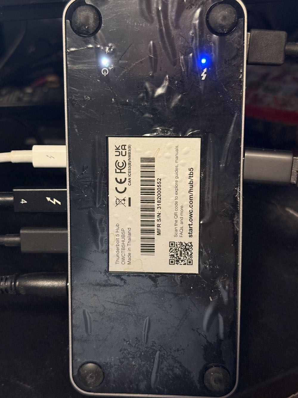

The TB5 hub has puts out 180W bus power and is limited to a theoretical 8000MB/s data + AV. Real world is probably around 5500MB/s limit — so, twice as fast as TB4. The housing is nearly twice as big, it has a power switch and fan. No 2-color LED on the top (booo!), instead a blue dot underneath to tell you if the uplink is working/off when it isn't. There's a white LED underneath to tell you if the power switch is on. Also, the uplink port has moved to the back — OWC Support gets lots of calls about this.
OWC support tells me that the LEDs on both units should be the same but he is wrong. I'm sending him pictures in case that there's supposed to be one on the top of the TB5 and I got a defect.
This picture shows the TB5 box on the left with my TB4 box on the left showing the Blue/White LEDs under the logo. Below that is the underside of the TB5 hub. My boxes still have the plastic over the top.
