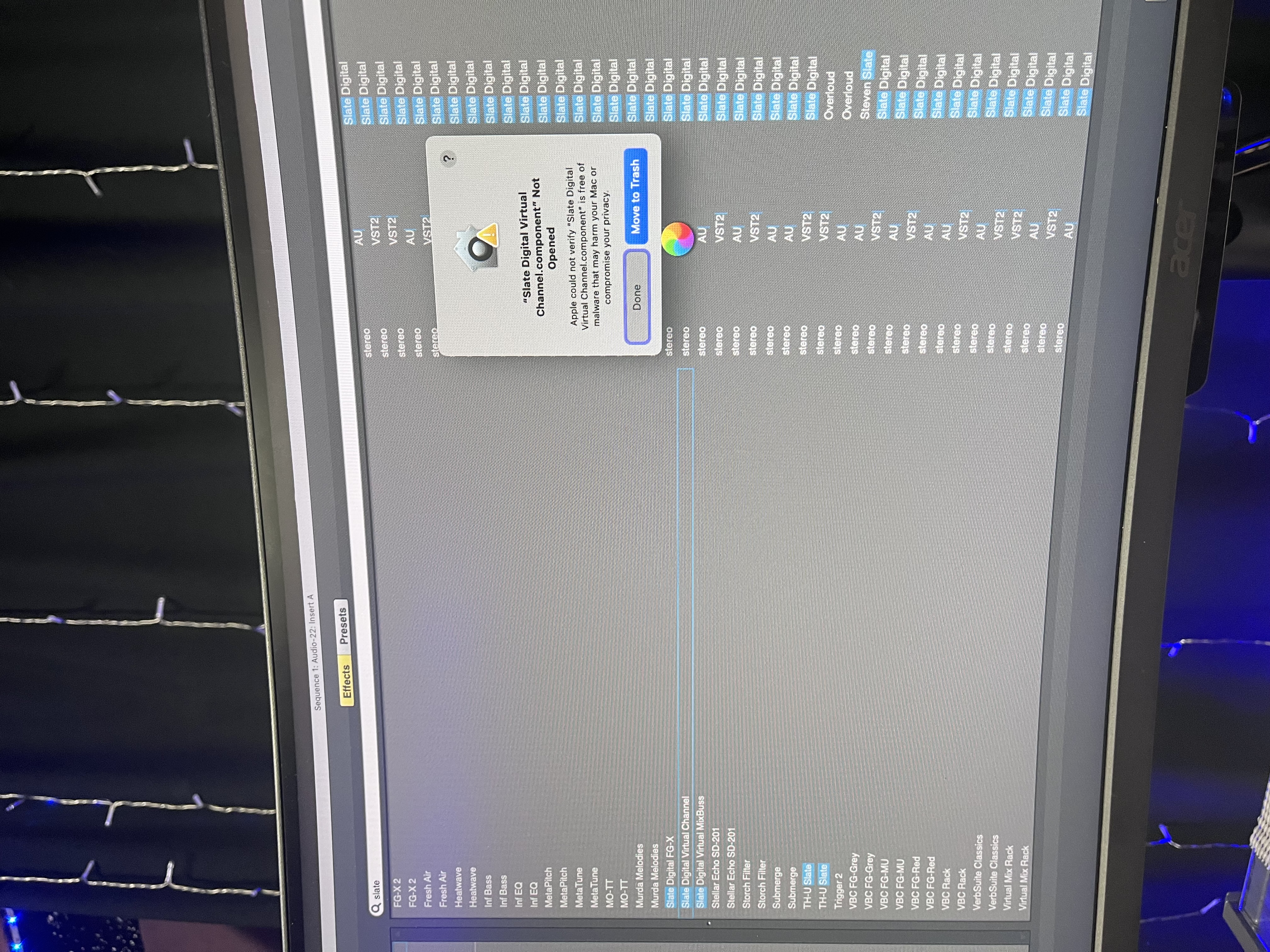

I opened a Slate plugin.. DP threw an error
I tried restarting several times..each time now it gets hung scanning
I rebooted with extensions off. No luck. DP would not open

ACTIVITY MONITOR OK
What was the error? Apple could not verify that the plugin is free of malware that may harm your computer or compromise you privacy
But DP passed the plugin?
Have you granted access to the microphone?
NOT THAT I AM AWARE OF
Are there any messages in System Settings/Privacy and Security?
Yes there was. I had to allow it anyway
And when I tried to open it, I got the same message about not being able to verify it was free of malware but was prompted to input my password in order to open it
It did open though!
So… how do I get the “unable to verify software is free of malware” message so I don’t have to keep outting my password in?

Update… for no known reason, it finally opened after spinning forever
It has to do with my Slate plugins
I am getting error messages saying that it can’t be opened due to apple not being to verify that the software is free of malware
I have to go to privacy and security to allow
Then still have to give permission with my password
The next time I open the plug it is ok
I’m going to shut down DP and see if it opens or hangs up again
