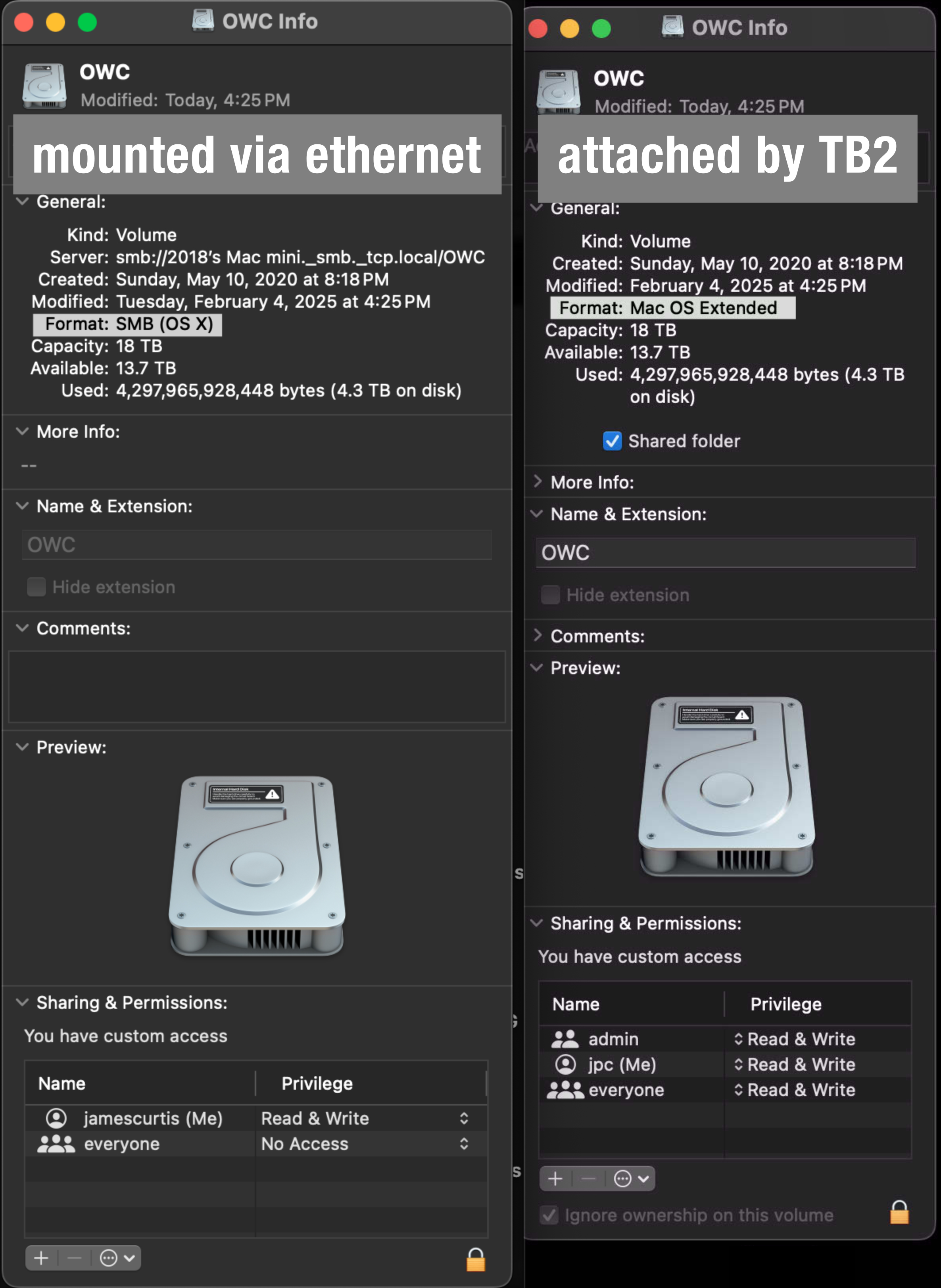

See attachment. This isn't from my NAS, but a shared RAID to show how the disk format looks when viewed locally or remotely.mikehalloran wrote: ↑Tue Feb 04, 2025 5:41 pmIf being accessed by Macs after Mojave, should be APFSeither APFS or Mac OS Extended.
I highlighted that Format field. Get Info on the same RAID:
- left side viewed on a computer on which the RAID is shared and mounted. Over ethernet, the format is SMB.
- right side is from the computer on which the disk is attached by TB2. Format is Mac OS Extended.
I don't think I can change the formatting now without completely erasing the RAID.
I get the errors trying to Save or record to any networked drive over ethernet.
That's interesting. I've gotten the same errors on three different computers.
- OWC RAID local and shared.jpg (1.44 MiB) Viewed 3376 times

Right away, the permissions are different when you mount the drive via ethernet, only "jamescurtis(me)" have access, it could be that DP is being refused access. It's worth investigating for sure, but "everyone" likely includes the application Digital Performer.
