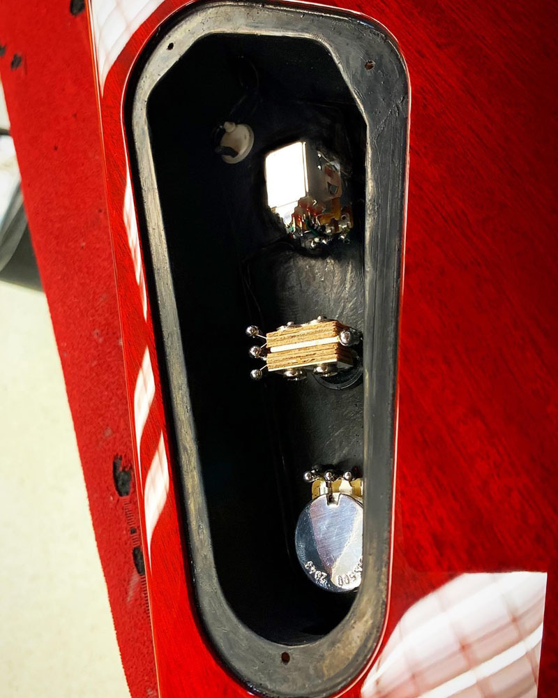

• Two volume controls (bridge/neck) with no tone. Toggle switch between volume knobs. Push/Pull pot on rear (neck) control switching both pickups to single coils.
• "Hidden" wiring

Here's a pic of the control cavity with special "hidden" wiring:
