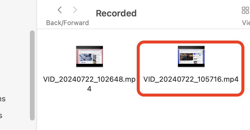

During the Record process, it had already done exactly what I wanted and made an mp4 — unwatermarked with audio intact. I can drop it into Premiere Elements, FinalCut Pro, iMovie or, if just exporting the audio, double-click and it opens in QuickTime where I can select Export Audio to wherever I like.
It's cross-platform so I don't know where these folders will be found but here are the Defaults for the Mac:
The screen recordings are found in Users/(user name)/Movies/Recorded
Since there is no possibility that I will ever edit video in this, I'm fine with knowing where the recordings are stashed. I could allow it to export with a watermark but that's more steps to create files that I will never use.
