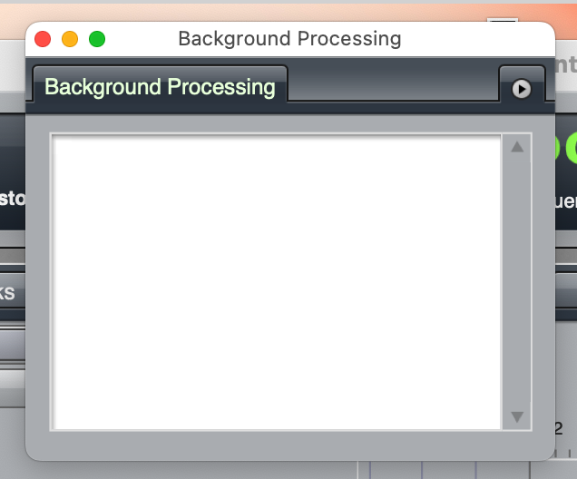

Apple's Activity Monitor and DP's Background Processing window can often show you what is hanging up.timsmolens wrote: ↑Thu Aug 31, 2023 10:46 am …
I recently got a new mac mini M2 and DP 11 and am experiencing very sluggish interface with half frozen Beach Balls that eventually clear.…
In the Activity Monitor, a spinning beach ball should turn a process red. Immediately double-click on it and drill down on the various tabs and processes highlighted in blue until the culprit is revealed. Among the many on my system over the years, I cannot have any Corel product installed on my Mac because of a licensing/update daemon. Roxio Toast doesn't use it but all other Corel products do. Anyway, if I download anything from them, even a demo, it can hang up any of my apps including DP until I remove it all.

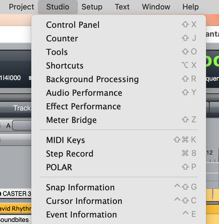

You can make the Background Processing window visible from the Studio menu and pop it out of the Consolidated Window if you like. If a process is trying to run or a plug trying to load that DP doesn't like, it should show up here. Often, if it's something that DP won't allow, it will try to load three times before the app gives up and moves on. It's been awhile but I have solved many problems in DP 7.24, 8.x and 9.51 thanks to watching processes fail in the Background Processing window.

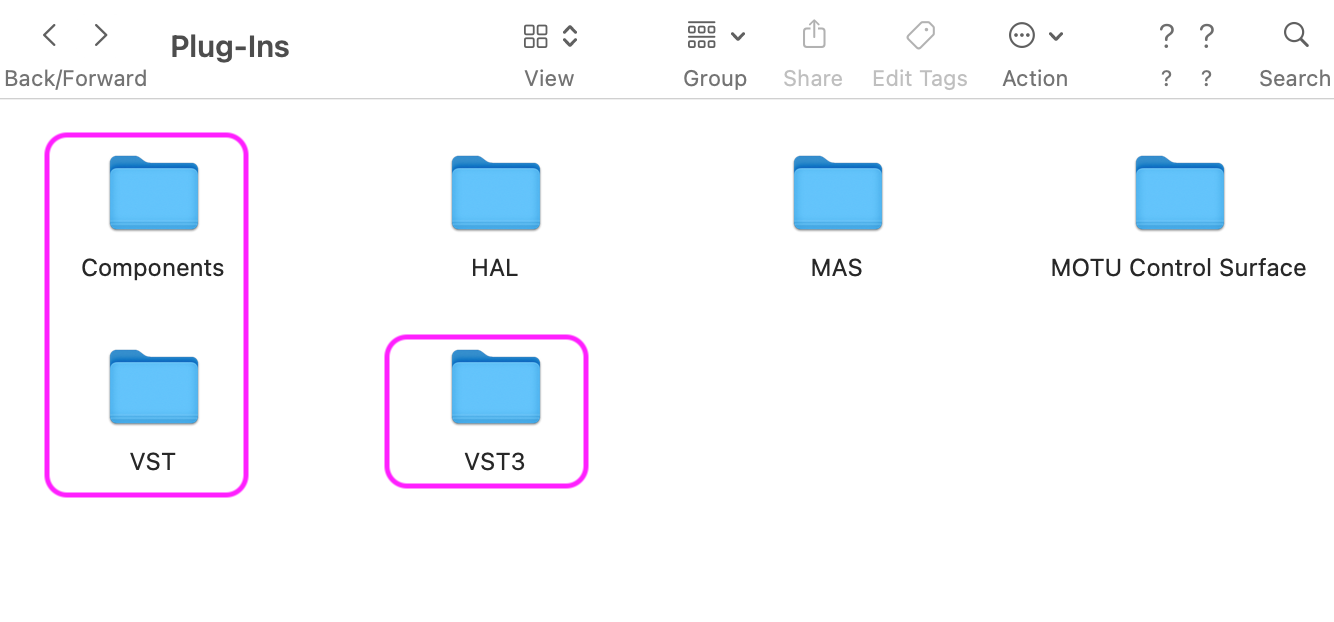

There are a couple more, but I don't remember right now. I sometimes get around this by running the VST3 version instead. Sometimes that will work if there's an issue with the AU.

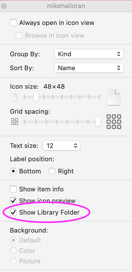

I recommend making the Users/(your name)/Library folder visible. This lets you just navigate to it instead of using the GO menu. Open (your name) and right-click on the empty space and click on View options to see this. I've circled the box to check. It's quite possible that an incompatible plug-in is the culprit. You can try to remove anything old or plan to reinstall only the latest versions of your plug-ins. Go to to MacintoshHD(or whatever your System Drive is named)/Library/Audio/Plug-ins. This is not your Users Library (see below). First, look into the MAS folder—in DP 11, it should be empty—if not, plan on uninstalling and reinstalling DP. Next, open your Components, VST and VST3 folders. Either remove anything not current or send the contents of all three folders to the Trash. Running GetInfo will be of little help since it will show the dates you moved the file over, not when they were created. In my case, I have files such as Ozone 2 in my folders when the current version is Ozone 10. My recommendation is to Trash and reinstall but if it's easy to tell what the old stuff is, give it a shot. There's no guarantee that DP is the problem but that's a good place to start. Here's the list of what should be removed for a complete uninstall of DP including the Application Support files.
