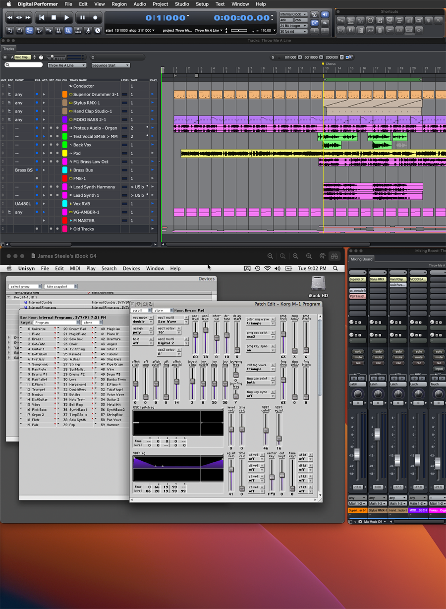

So after much digging I found my original Unisyn installer CD and put Unisyn on it. It works. Then I had to upgrade to a bit newer MOTU MIDI driver and it sees my MIDI Express XT!! I disconnected the MEXT from the hub connected to my Mac Studio and connected it to the iBook G4, and it saw the MEXT and I configured my devices and it all works.
So then I set up screen sharing and even though the OS is so much older, the screen sharing is working with Ventura and I can control Unisyn on the iBook G4 from my Mac Studio! Check out the screen capture:
