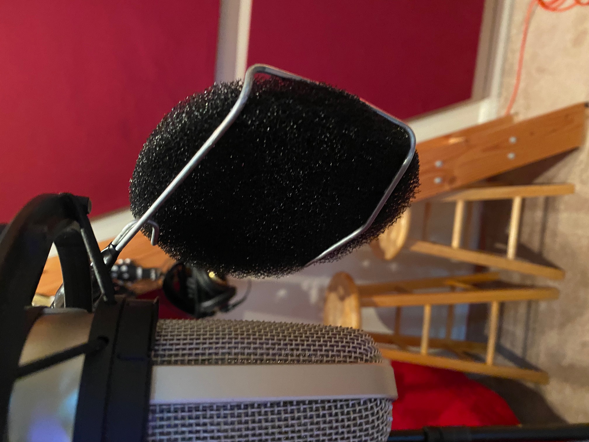

Got my Aquarium Filters.
Although I ordered one of the Pseudo-Hakan ones Mike found, I couldn't resist bending a little wire...
I am going to retire the panty hose.

Looks great!
Being the one-armed guy, I’ll not be doing much wire bending but I do have a bench vise and ViseGrips if needed and I ain’t afraid to use them!

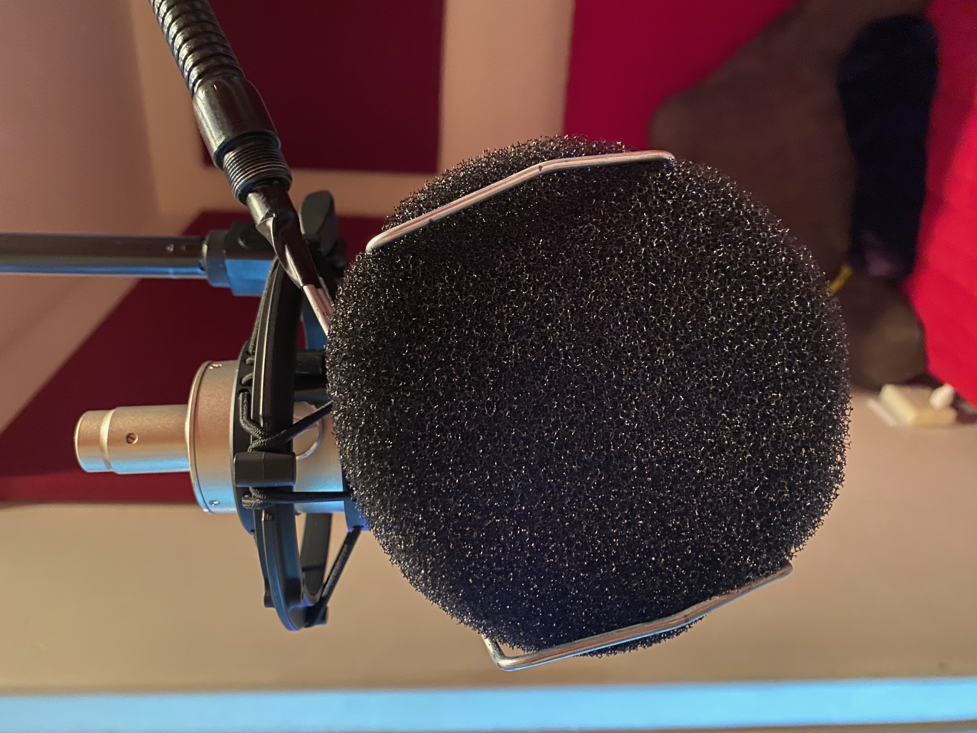

Everything came in. Here are some comparisons etc.mikehalloran wrote: ↑Sat Jan 21, 2023 10:27 am Look what I just found for $17.on Amazon
https://www.amazon.com/Microphone-Pop- ... _1_13_sspa
Ordering this with a pack of the filters right now.
I did not order the Hakan, of course but the $17 Amazon appears to be identical including the 13" gooseneck.
The $17 and the aqua filters appear to be the same material. EDIT: After a few days, the filters expanded to the same thickness and the material now appears to be identical.

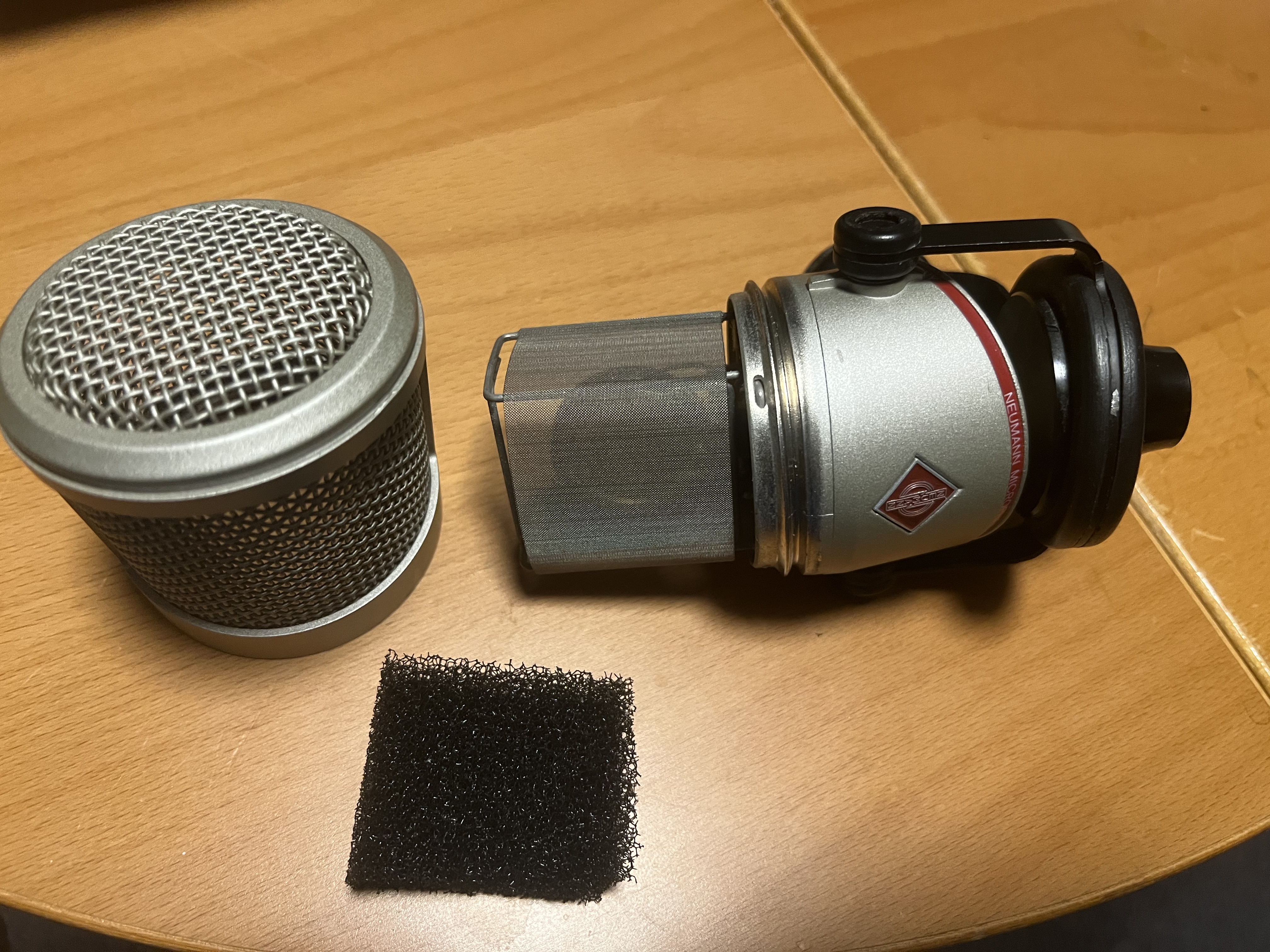

That polyester media is really easy to cut with scissors, much more so than foam rubber. I have a few places to use custom shapes. A needle and thread should hold this in place while I re-attach the grille on my BCM 705 but it can be done to make it more useful on some voices.
One of my favorite live vocal mics for decades was the Shure 545/SM57 with the Shure A2WS-GRA Locking Foam Windscreen. It had a pad of open cell foam between the sock and the grill. If I ever use one again, a cheapo foam sock with a circle of this underneath should give the same 'plosive reduction.

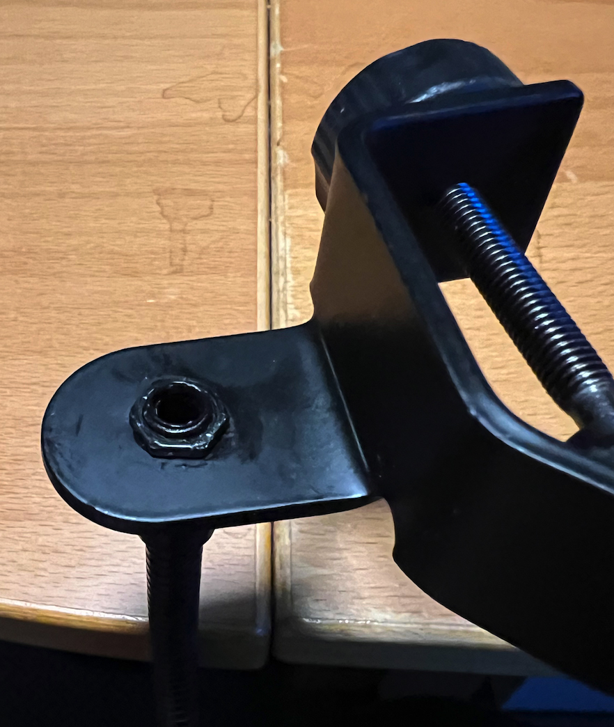

If you read reviews of the high priced version, many are negative because of a problem with the gooseneck. Seems it only works properly when it's straight. I found and fixed it on my $17 version.
The clue is that, when it's straight, there's no problem—a weak gooseneck would be most likely to droop when straight. The real problem is the attachment—it's held on be a 10mm nut that isn't properly tightened. A 10mm or 3/8" wrench or nut driver will cinch it down. If you can't get it to hold as firmly as you want, I recommend backing it off a bit and using a small drop of glue between the gooseneck and the clamp (not on the thread side!) before re-tightening the nut. Silicone, rubber cement, superglue or epoxy — any will work but the first two adhesives are removable.
In any case, problem solved.

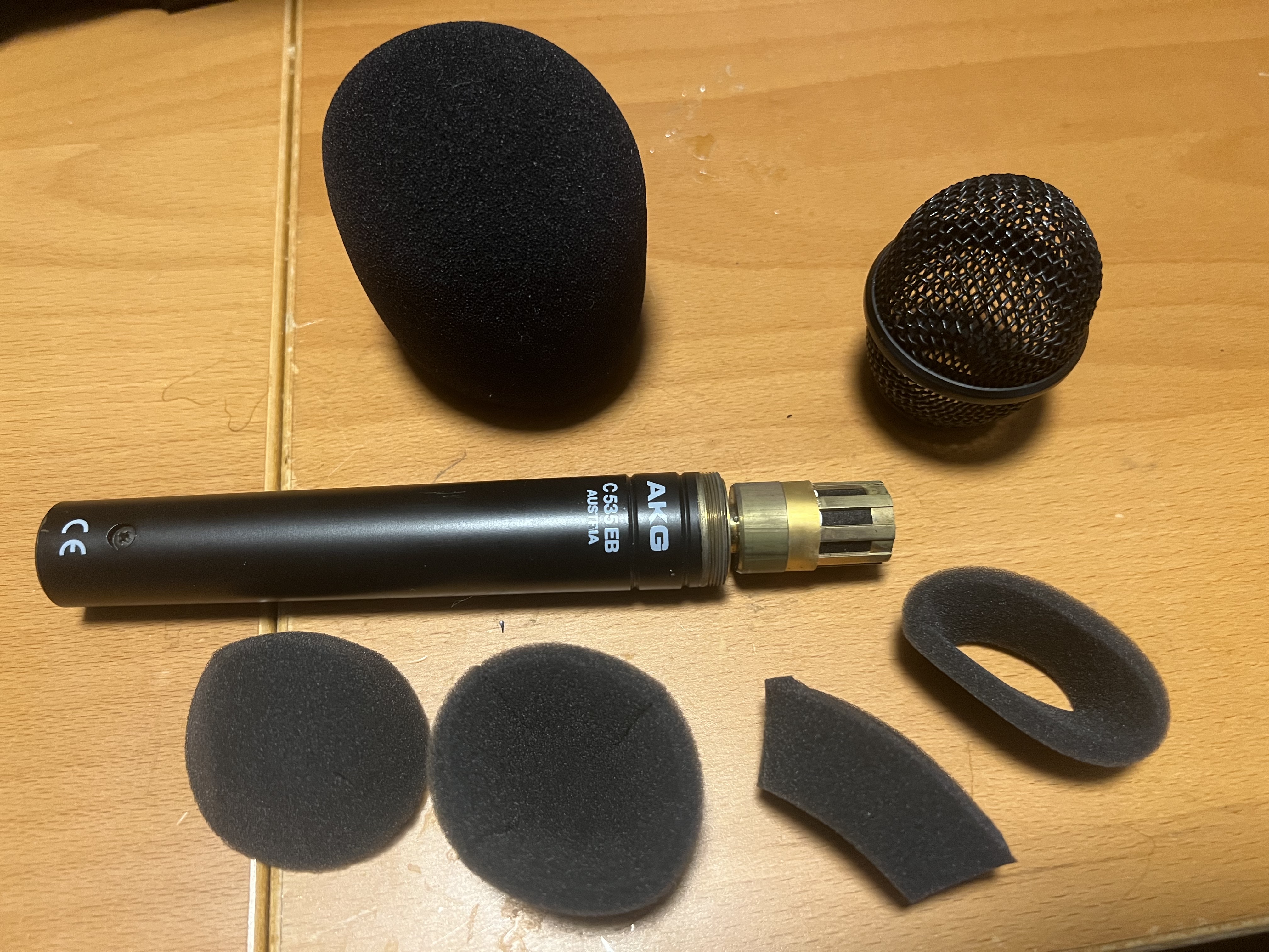

I have a couple of AKG C535EBs where the rubber inside the grille is rotted away—the resulting crud blocks sound and makes these useless. Removing the foam and using cheapo SM58 windsocks over the grilles brought them back to life but I never intended that to be a permanent solution. So I special ordered a couple of (damned expensive) AKG rebuild kits for these and received them just last week. I have already found 1/2" thick sheets of this aqua filter media https://www.amazon.com/dp/B0B3LLFVPV/re ... ail_0?th=1 and am looking for 3/8". My plan is to try rebuilding those grilles with that first. Worst case, I have to install these anyway:
