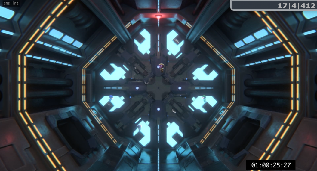

Here's what my workaround might look like - the colours of the counter follow DP's theme's, but unfortunately not the font, I just discovered.
A lot of apps could comp in a screen cap of just DP's counter into a movie (iMovie on a Mac), but that would definitely be in Frankenstein territory.
- Counter.png (894.46 KiB) Viewed 8360 times
- Counter 2.png (825.91 KiB) Viewed 8354 times
Re: I need to create a video for the conductor with bar/beat counter
Wow! Thank you very much! I am quite astonished that there is not one single theme that offers white digits on black background... Or did I miss one?
Also, can you tell me how it's possible to get te chunk title in the same text size as the Timecode and the Counter like in the lower example? Which theme and adjustments did ouy choose here?

That's actually a Marker....which seems like it could be useful for a conductor? The resizable counter allows for 3 lines. I have Markers as the third line in that exampleGBMusik wrote: ↑Mon Nov 21, 2022 1:52 am Wow! Thank you very much! I am quite astonished that there is not one single theme that offers white digits on black background... Or did I miss one?
