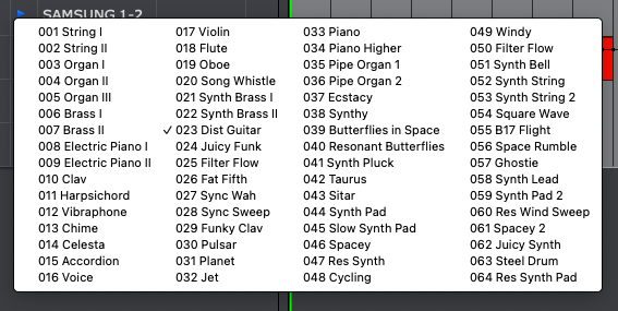

OMG... too cool. I found the ".midnam" files for my custom patchlists I made in Cherry Picker and put them in the correct folder, <hard drive>/Library/Audio/MIDI Devices/MOTU/<manufacturer>/ and Bob's your uncle!! Too cool. This is my Roland MKS-30 custom patchlist! I'm just blown away this still works on the new Mac Studio!
