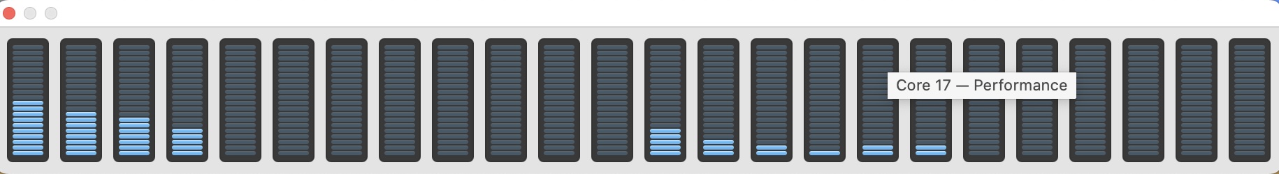

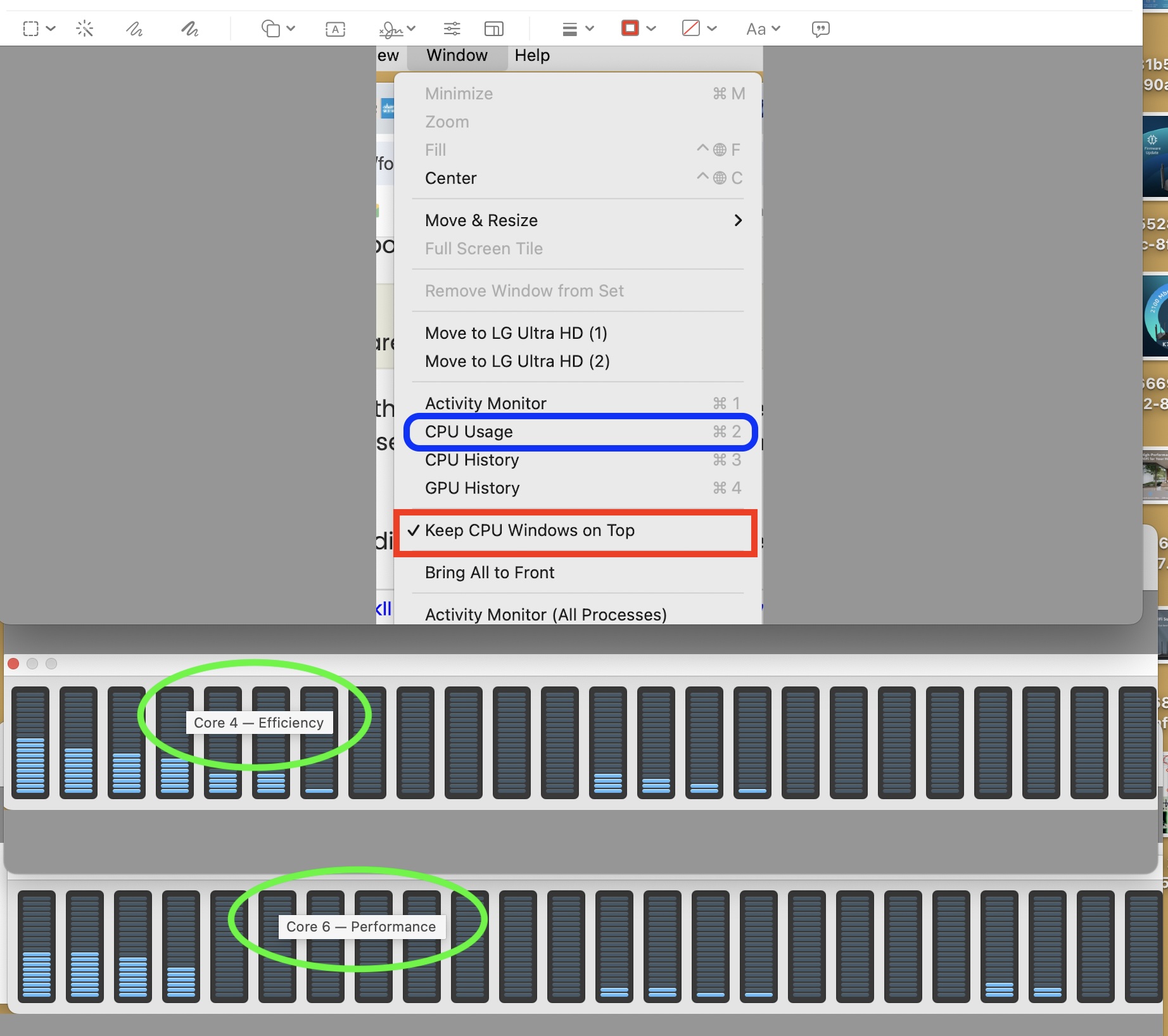

Revisiting a nearly 2-year old thread--I'm on DP 11.3 and Ventura 13.6.3. I've got a Mac Studio Ultra M1 with 40 cores, 64GB RAM.
The processor meter within Activity Monitor shows 20 meters. ( I assume those are the performance cores, the unseen 20 must be the efficiency cores? Not sure--need to check that--typing this on another computer!)
These 20 core meters are NEVER all fully utilized, which I find frustrating as I peg the processor meter within DP with a modest session assembled. (I"m sure I've mentioned this on Motunation before but I'm still searching for a solution.)
Usually about 4 of the core meters are showing any workload, and the others are barely moving, or show zero activity.
I keep the core meter visible at all times on my desktop.
My sessions usually contain 5-8 virtual instruments, 2 FX AUXes, (only running usually 1 reverb and 1 delay, sending things to these auxes.). I'll address these VIs with between 10-15 MIDI tracks. I may run 5-8 audio tracks MAX. Also, I'm UA UAD-2 Apollo x8 user with 10 cores of off-Mac DSP acceleration. (6 in the x8 and 4 in a hardware TB satellite box.)
My reverbs/delays are UAD-2.

My sample buffer is usually at 512. Of course the problem is MUCH worse when I populate the master fader with plug-ins, but even without any inserts on the master, I'm still not getting the performance I expected from the Mac Studio Ultra M1.
My new workflow is the have no inserts on the master fader until I'm ready to mix.
Especially puzzling is the seemingly unbelievable fact that the Mac's performance cores are not being fully-utilized. As I search across the internet, I'm learning that MANY DAWS do not support full implementation of Apple silicon performance cores. Even Logic Pro underperforms.
What gives?? Who is to blame here? Apple, or the third-parry vendors?
I'm using VIs like: Musio, Opus, Trilian, Omnisphere, Addictive Drums 2, BFD3, etc. Falcon and Kontakt 7 less often.

Except for certain multi-core Instruments (Players), each instance uses one core. This is true for Mac and Windows and all DAWs.
The UVI Player, for example, does not support multicore. If you want to balance the VIs among the cores each one must be called up in a separate instance of the UVI Player. The OS balances the instances among the cores. Depending on your plug-ins, it is possible to have a thousand tracks, each with a separate instance and plug-ins in DP, Logic, ProTools etc.
Kontakt can be single core or multi-core Instrument Player, depending on how it is set up.

Those that do support multiple cores must be set up per the instructions for the player. Besides Kontakt, some of the piano players support multiple cores.
We’ve been discussing this around here since the quad core G4.
One instance per core. An instance can host one or many VIs. UVI, ARIA, SampleTank, EXS24 and most others do not support multi-core.Mike, you state that only one core is assigned per VI. Is this simply a limitation of the third-party plug-ins’ design? I believe you mentioned Kontakt can be ran multicore.
I’m not sure that any are better. Logic may be the least intuitive despite Apple’s many tech bulletins on this. ESX24 is the default Player but it seems that only experienced film composers know to call up a new instance for each VI — and Apple has a ton of themSo why are some better that DP at this task?

Hi Greg,greg328 wrote: ↑Sun Mar 31, 2024 1:48 pm Revisiting a nearly 2-year old thread--I'm on DP 11.3 and Ventura 13.6.3. I've got a Mac Studio Ultra M1 with 40 cores, 64GB RAM.
I get horrible latency when inputting live MIDI through these VIs. Not as bad when triggering my Montage M hardware synth.
(By the way, when I ran MIIDI directly into the Mac Studio via USB from Montage M, I got extremely weird MIDI timing problems-namely, inputted notes were printing EARLY on the timeline. I moved back to my MIDI I/O using my trusty MTP AV USB and input timing is MUCH better!)
The 2 DAWS that seem to be able to access all the available power are Cubase 13 and Reaper. I hope it's OK to mention these, I in no way support these DAWS, just trying to understand more why our beloved DP is not performing as well as it might, with better programming.
I've been a user of MOTU software and hardware since 1989, so I've been with DP since V1! I'm a huge supporter, but I need more performance from it--especially after a rather large investment in the Mac Studio Ultra M1.
Anyone have any insight on lack of multi-core support/performance with DP 11? Does Sonoma OS 14 solve any of these issues? I'm still waiting on OS 14 as I'm in the middle of a large album project and can't afford a train wreck caused by an update!
Many thanks,
Greg

- Posts: 16273
Re: DP11 on M1 — only utilizing using 4 cores?
True of macOS, Windows and UNIX/LINUX.apparently the OS decides how work gets prioritized onto which cores,
Not everyone understands how to view Cores in the Activity Monitor. As we can see, one has to select the View under Window in the Activity Monitor. Hovering over any individual Core tells you whether it's an Efficiency or Performance core.
Here is a snapshot of the 24 cores of my M2 Studio Ultra hard at work in my latest DP project. The only Performance Cores showing any work at all are #s 17 and 18. Cores 1–4 and 13–16 are Efficiency Cores.
- Posts: 3863
Like Mike said. Plus the CPU history window has the cores always labeled.
IMO between the Effect Performance Window in DP and the two CPU windows in Activity Monitor it's not that hard to determine what DP is doing with your CPU, and to adjust performance accordingly.
