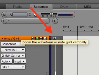

The image below shows the zoom slider in the Sequence Editor. Is this specific zoom in the Commands window somewhere under a different name? I don't find this particular vertical zoom there, which zooms the waveform or note grid without changing the height of the tracks. I'd love to adjust this with the keyboard if possible.

The magnifying glass icon in your screenshot is for vertical zooming of the waveform view. If you want to zoom horizontally, yes there are extensive key commands to do so. Go to the Setup menu>Commands and type Zoom into the top of the window.

Yes, I know, and this zoom behaves a little differently from "Zoom in Vertically." This one does not resize the track vertically in the Sequence editor, it only zooms the waveform or MIDI without adjusting the track height. I use it all the time, and I would like to access it with the keyboard instead of the mouse. It does not appear to be in the Commands window, and therefore it appears impossible to create a shortcut for it.

@bayswater - Indeed, I want the tracks to zoom vertically without changing height, and I'd prefer to do that without using the mouse if possible.
@magicd - My specific situation at the moment is editing many thousands of samples for new sample libraries. I need to alternately see the attacks and the nearly-invisible note tails, so I'm zooming vertically in and out of audio constantly. In the sequence editor I set the track heights so that the set of tracks I'm currently editing fills the screen. I'd like to vertically zoom the audio without changing the track heights so that the things I'm working on don't jump around and stay on screen.
The software can do this but it seems to only be accessible by clicking this little icon with the mouse, which slows me down quite a bit when doing it thousands of times over. Is there no keyboard command available for this particular zoom in the sequence editor?
