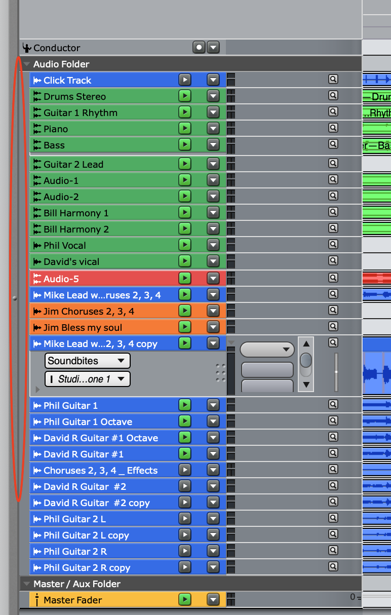

I used DP decades ago, so it's like I'm starting from scratch - I have some old projects I'm trying to do some recovery on. Some of them are (multichannel audio mix to) stereo only - 24/48 - which I would like to output/bounce as 16/44.1 WAV and MP3 files.

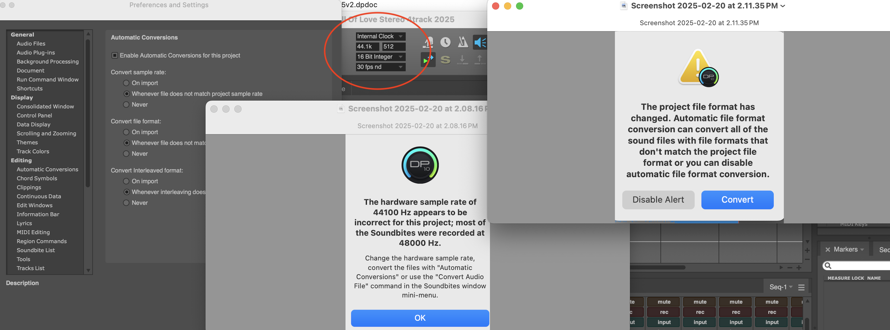

Simple enough but I get peppered with warning dialogs if I try to change the project sample rate and bit depth (red circle)
Am I changing it in the wrong place?
The second I use the suggested Automatic Conversions preference - the sound stops. No output.
One thing that works (I found online) involves converting the individual soundbites (each audio file), then reassign those to tracks - in order to achieve that one simple output conversion thing. It seems strange and cumbersome - especially considering I can real time convert bounced outputs to anything I want right in the bounce window in Logic. (Sorry I said the L word)
It seems so simple but it's not - to me in my preschool level of experience in DP10. Any ideas?

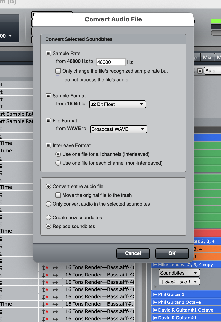

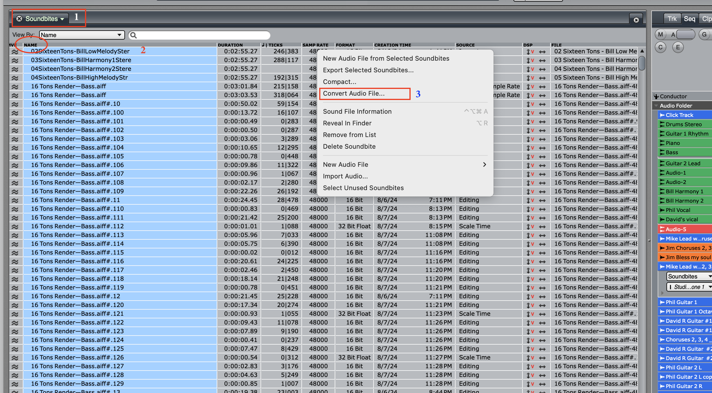

Open a DP Project and go to the Soundbites tab. Click-drag the next to left panel to the Left.
1) Change the top tab to Soundbites—this reveals all of them. This file has tracks imported from other studios than mine — scrolling down will reveal some at 44.1. You will note that these have multiple bit depths. 16bit severely limits my headroom and I want everything in 48k. So...
2) Click on the top soundbite under NAME and drag all the way to the bottom to select them all.
3) Right-click anywhere to reveal the next window and select Convert Audio File...
Change to the Sample Rate and Format. These are the settings I use. I find that 32bit gives me much greater headroom for processing.
attachment=0]Screenshot 2025-02-21 at 2.37.40 PM.png[/attachment]
