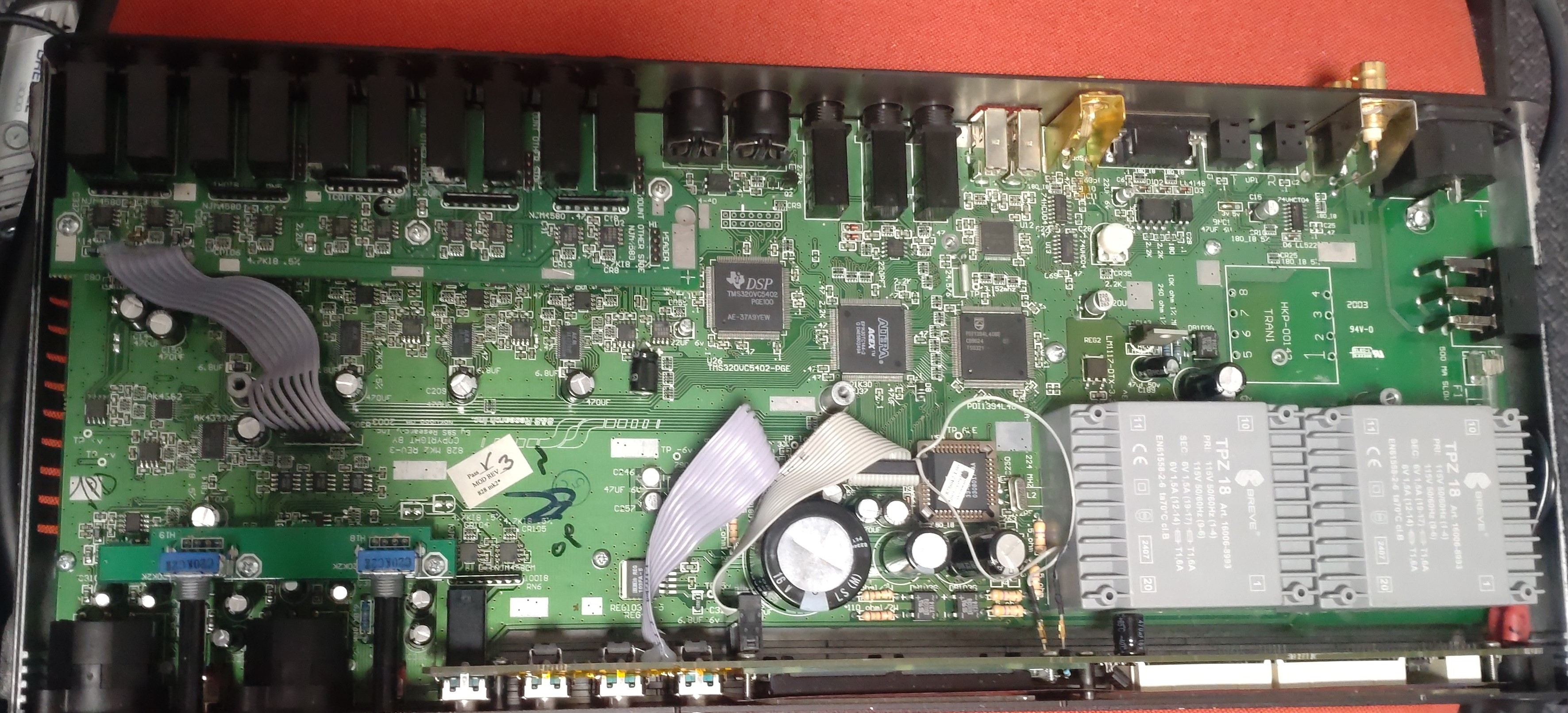

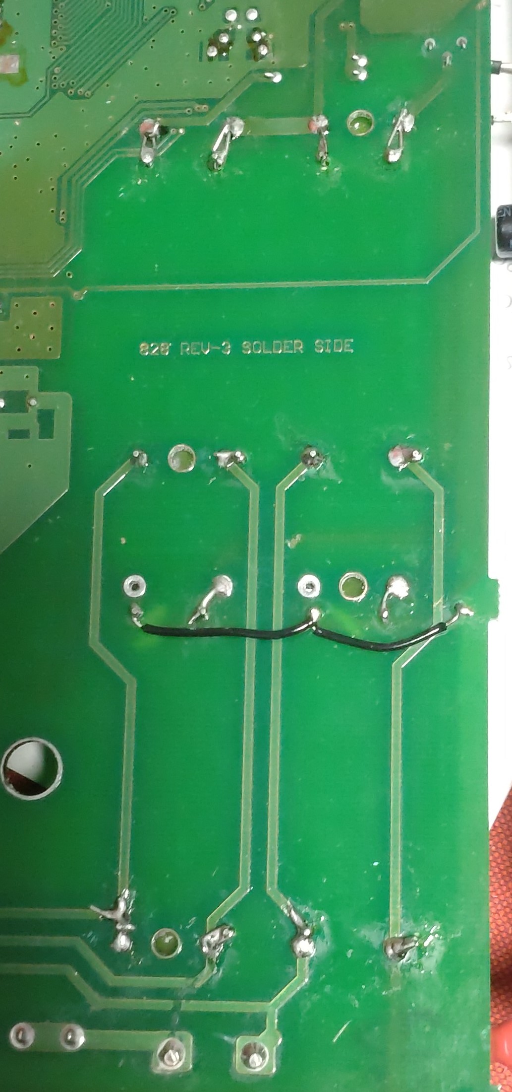

Re: 828 MkII Humming!
After recapping, I was still annoyed by the rather loud PSU transformers. You could hear the 50Hz hum 10 feet away.
I fixed that, by replacing the transformers for closed, potted ones. They are Polish Breve units, TPZ18/2X115/2X6V. They are bit smaller power than originals but seems they are easily big enough. No heat issues -also the fact that they are 6V instead 6.3 reduces the heat output a little. I had to drill new holes to the PCB and reroute some traces, but it was no biggie if you have experience in this sort of thing. It is a bit tight fit.. I also removed the phantom power transformer as I don't have any need for it.
Its now very quiet, you can hear hum only if you put your ear to it.
