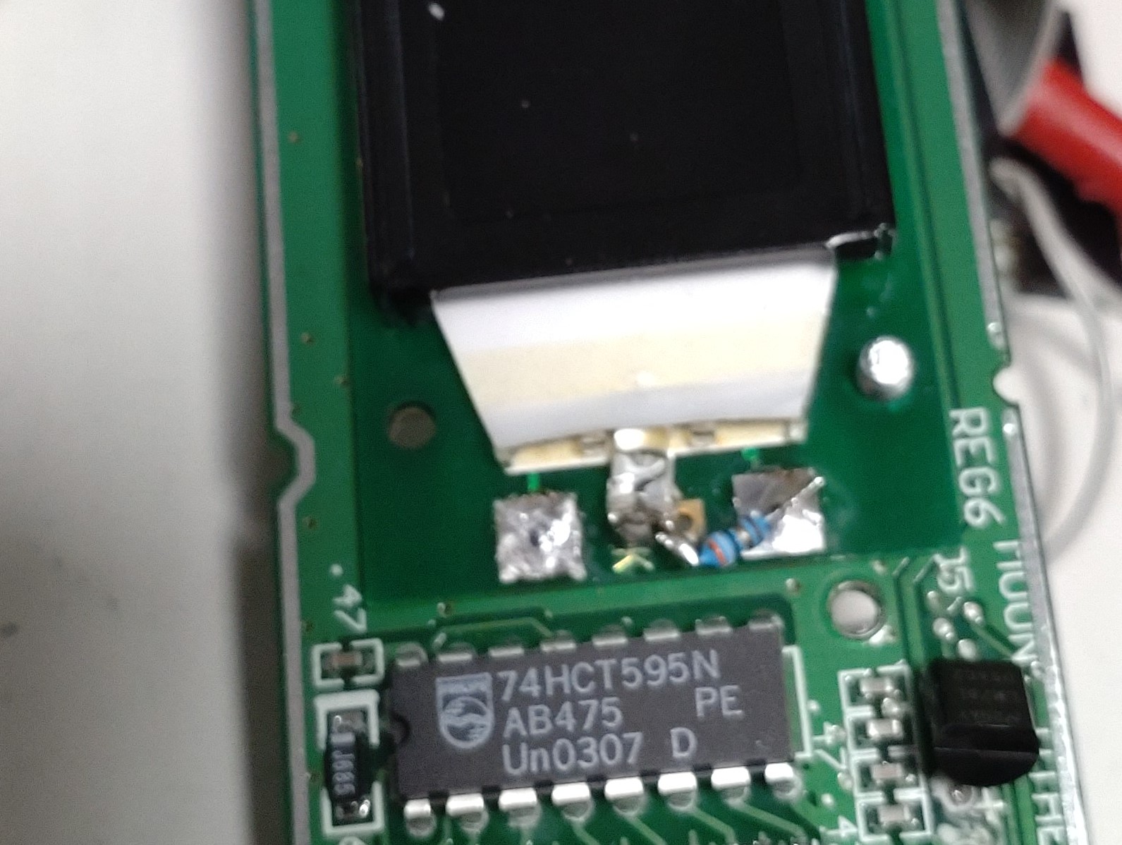

Re: 828 MK II LEDs crap out..
You can pull the old backlight out as described in many documents. The suitable replacement is a 3mm (not 5mm) "superbright" led, which will actually fit the light guide. There are unused pads there, connect led cathode to "K", and bend it so its shines directly to the backlight plastic lightguide.
The anode side must be run to the big pad via a resistor. I put a 39ohm 1/8w one in mine. (It depends on the led). The anode side of the pad is not connected to anywhere....

My issue isn't with that display, it's with the LED meters to the right of that. For each channel that is active, there is a green (single) LED that shows you there is audio traffic. The Input meters over top of those light up whenever I'm recording or playing back from the PC since the Input to the 828 is via the channel strip Direct Outs. So, whether its live or memorex there is always activity on the inputs. Thats where my blinking is coming from, not the GAIN/MIX display
