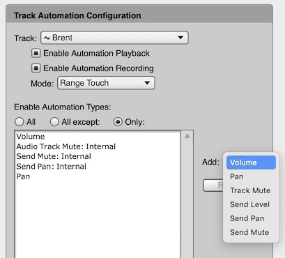

Turns out the issue I was seeing was only on that one track. All other tracks behaved normally wrt Range Touch and Range Latch automation. I had the idea of checking the Automation Setup dialog for that track and saw something strange - all my other tracks were set to Enable "ALL" automation, except the misbehaving track. Instead, it showed this:
What's strange is that there's two entries for volume. I looked in the manual to see what the difference was between "Audio Volume: Internal" and plain "Volume" but found no references to this. AAMOF if you start with nothing, select "Only" then go to the little drop-down on the right and select "Volume", that's how it appears in the box - not "Audio Volume: Internal."
Anyway - I deleted the two entries I saw, selected "ALL" for "Enable Automation Types:" and now Range Touch and Range Latch work as they should.
