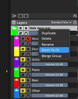

Just posting this in case other users of Spectral Layers 11 (this does not apply to 10) on Apple Silicon Macs are having this issue. When you load in a project, you won't see anything in the Window where the spectral display should appear. This is a known issue and Steinberg has said they will fix with a 11.0.40 update shortly.
In the meantime, you could fix it by launching it in Rosetta 2 (but that blows!) so what you need to do is go down to the lower right and right-click the name of the audio file and choose "Zoom to Fit" and the display will return.
I've also found that if you save the project with the timeline fully zoomed out on next open it will be blank and you have to repeat this and then your'e fine again, but if you zoom in just one notch on the timeline and save, when you open it again the display will be there.
