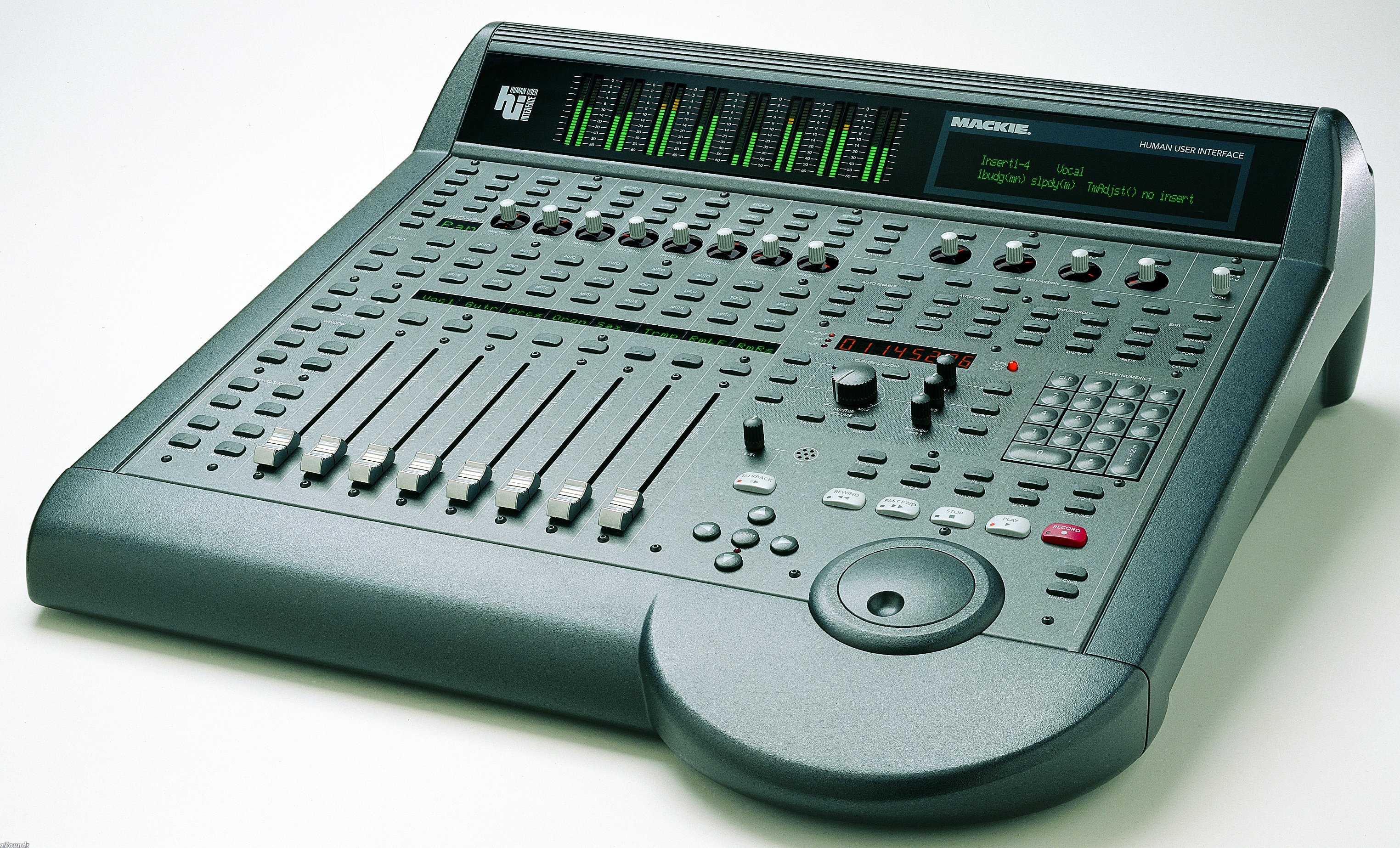

While HUI and Mackie are, as you say, independent protocols, the 'Mackie HUI' is also a unit in itself:
