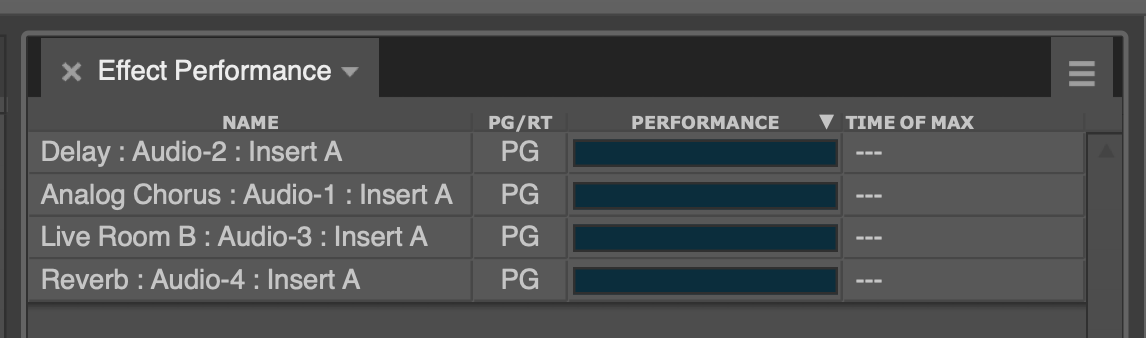

Have you looked at Effect Performance? Open up a sidebar in the Consolidated window, and add Effects Performance window to see what your plugins are doing. It looks like this.
Screenshot 2024-09-02 at 12.47.49 PM.png (53.41 KiB) Viewed 1069 times
When running it will tell you the resources used by plugins. That might explain what you are seeing.
