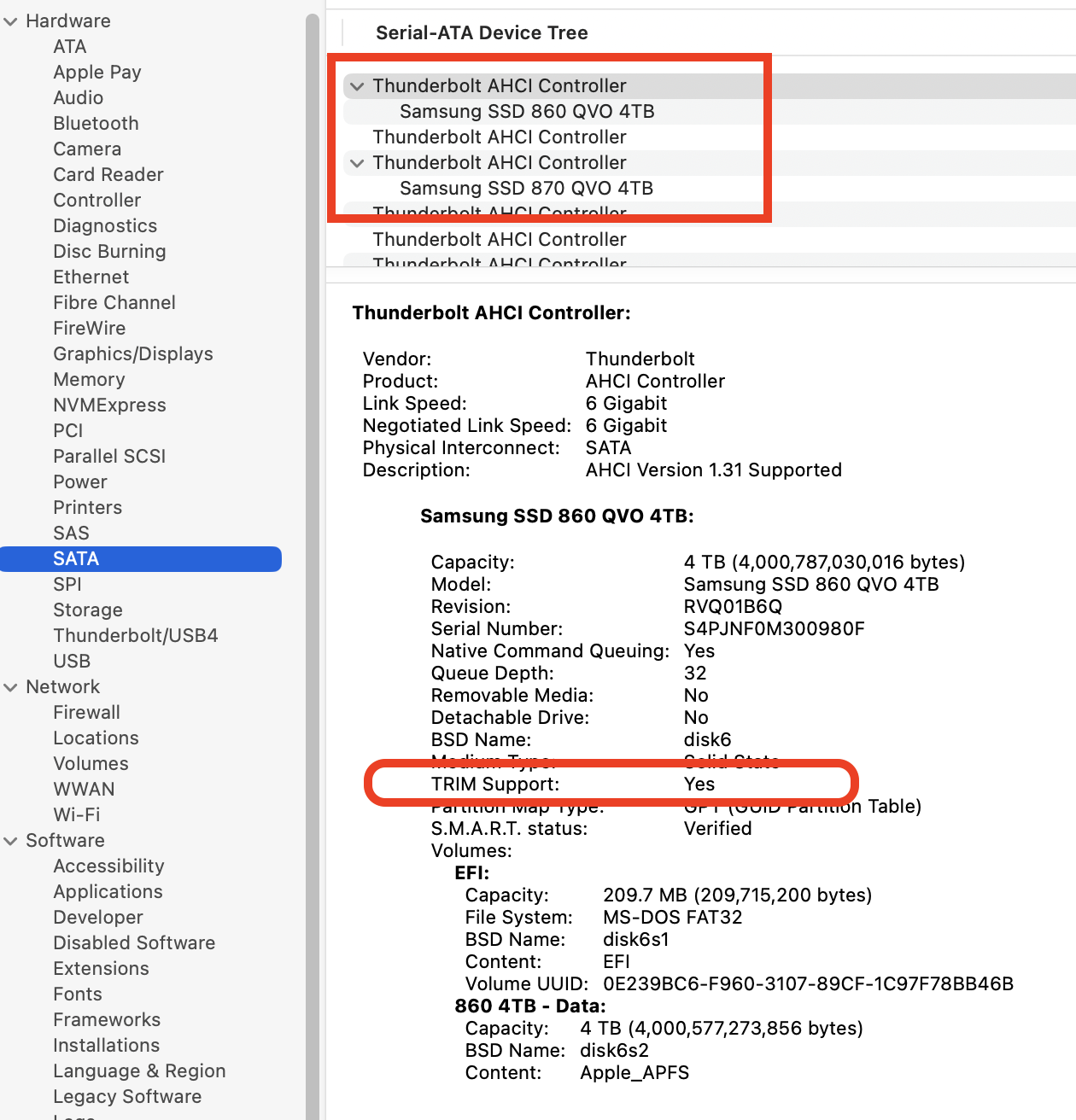

Updating this old thread...
I still have a pair of 2.5" SATA III SSDs sitting in an old OWC TB2 Dock connected to my Studio via the Apple TB2–TB3 adapter. For that reason, this topic still interests me.
There's been a lot of yak, yak, yak. lately that as of Sonoma, the macOS no longer shows the TRIM status on 2.5" SSDs connected over PCIe, Thunderbolt USB4 or eSATA. (these are the only drives where this ever mattered—TRIM was always blocked over Ethernet, Firewire and USB 1.1–3.2). Anyway, this noise is incorrect.
True, System Report in Sonoma no longer shows the drives connected in the TB/USB4 busses. Instead, Storage has its own listing and TRIM is no longer shown.
Screenshot 2024-07-25 at 1.15.44 PM.png (232.2 KiB) Viewed 2886 times
Apparently, no one knows where to look. Clicking on SATA lets you see your drives and their TRIM status.
Screenshot 2024-07-25 at 1.32.46 PM.png (379.35 KiB) Viewed 2886 times
sudo trimforce enable still works in Terminal as it has since Yosemite 10.10.4 and should be run to remove the block from 2.5" SSDs connected via USB4, Thunderbolt, PCIe and eSATA.
TRIM still speeds the preparation of cells to accept new data after a file has been deleted. TRIM is is automatically enabled for NVMe blades other than those connected via Ethernet, Firewire and USB 1.1–3.2.
