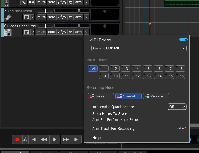

I have a KORG PA5X that I often use just as a MIDI only keyboard. And, I have a NI S88 MIDI only keyboard. In Mixcraft 10.x this is very easy to perform, select the Instrument and then select the MIDI keyboard from a dropdown on the track - super simple and fast. In the case of my KORG it registers as "Generic USB MIDI" and the NI S88 registers as "KONTROL S88 MK3" as seen here:
Here are my MIDI keyboard selections:
Track 7 NI S88
Track 8 KORG (Generic USB MIDI)
In DP, I Add a Instrument track, Add a MIDI track, on the MIDI track associate the MIDI track to the Instrument track. However I can't find how I assign a specific MIDI keyboard. This is a problem because I want to have one keyboard (KORG PA5X) be the source for a specific MIDI tracks and the NI S88 to be the source for other MIDI tracks. As it stands right now the both play on ALL MIDI tracks ... not good.
