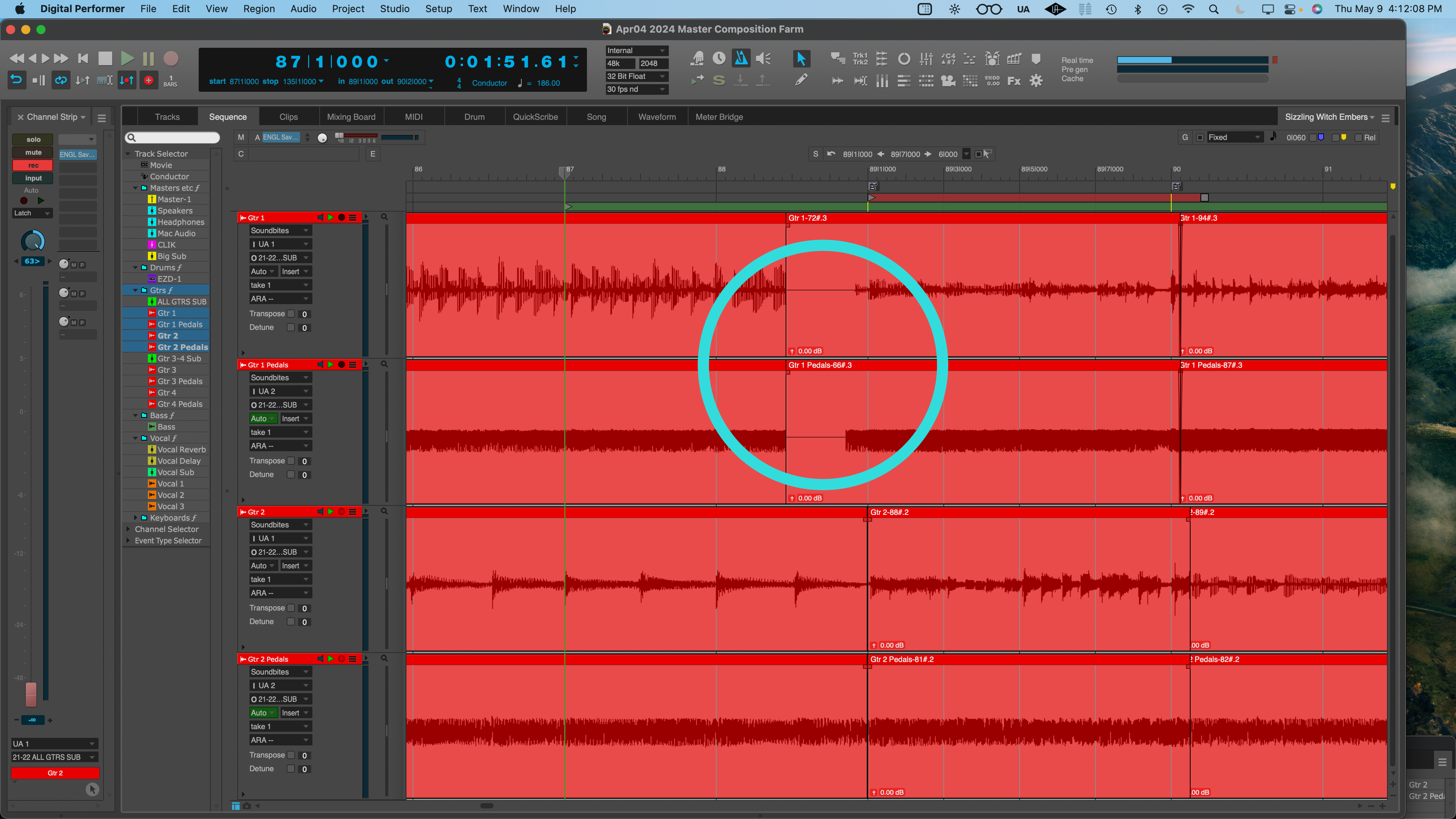

I have DP (current version on Monterey) set to record pre-roll. PunchGuard is set to "Always record pre-roll", and Retrospective Audio Record is set to one minute / 1gb.
But what I get is like in the screenshot - digital silence followed by maybe a half second of actual audio before the punch in. I do remember this working in the way I expected until sometime kind of recently. Am I doing something wrong? There should be either 30 sec or 60 sec recorded from the pre-roll, no?

I found this a bit confusing too. It doesn't seem to do what the settings say. But, can you drag the left border of the recorded soundbite to show audio recorded for the pre-roll time you set? I can do that and see 4 seconds of audio that was hidden.
What is still confusing is that I don't see the little bit of audio recorded just before the red record bar that show in your screenshot. All I see is a soundbite exactly the same size as the red bar until I drag the soundbite edges.

In the screenshot I had already pulled the left side of the soundbite back to find audio had not been recorded correctly in the pre roll. There should have been 30 seconds of audio in pre roll. It’s only about an 1/8th note of non-digital black here though.
The punch in here was at 89/1/000 but I’d already been playing for probably two bars. I think that pre roll audio is supposed to be recorded, according to how my prefs are set. But it only started recording audio at 88/4/240 or so. The dragged out soundbite is there but it’s mostly blank.
Are you saying this is not the same behavior you find?

It is not, but then I wasn’t trying to record that much in the pre-roll.. Will try later to see if there is maybe a limit to how long you can capture.Irimi Nage wrote: ↑Fri May 10, 2024 9:31 am In the screenshot I had already pulled the left side of the soundbite back to find audio had not been recorded correctly in the pre roll. There should have been 30 seconds of audio in pre roll. It’s only about an 1/8th note of non-digital black here though.
EDIT, had a chance to check it. Set pre-roll to 30 seconds and was able to drag the left edge of the recorded soundbite back 30 seconds and see recorded material. As earlier, the post roll setting was ignored, and the recording carried on as long as the transport was running.
So I guess I’m not seeing the same thing. I tested this on DP 11.3 but under macOS 10.13.6.

Tried this on my other Mac using Monterey/DP 11.3, and it works properly. Sorry, don't know why you're not getting the correct pre-roll -- I can't repeat the problem.
