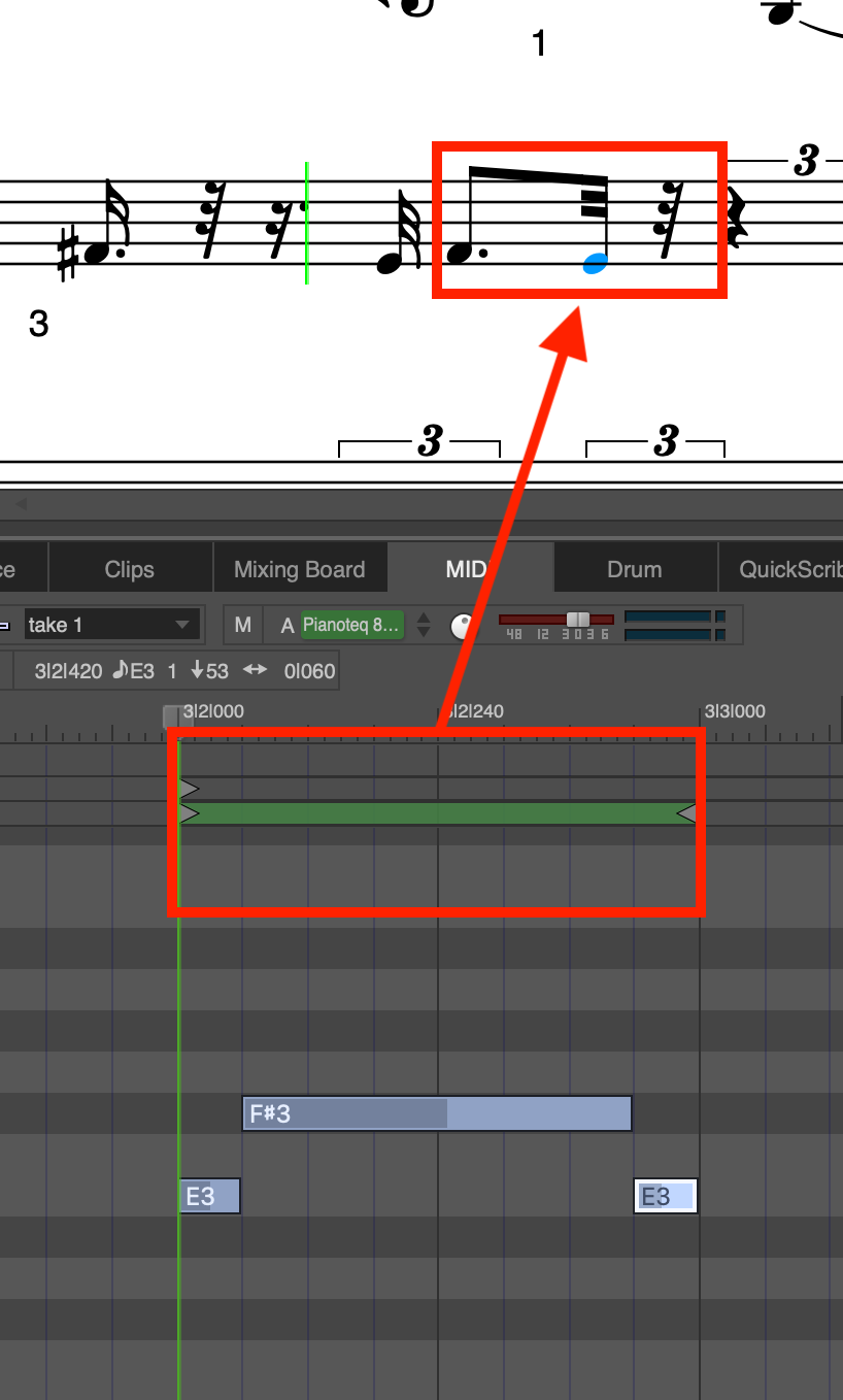

Above is the notation of the selected notes below.
It displays 8-tuplets instead of 32-notes (tied): I have shortened the overlapping notes to see if it will display 32-notes, it does, but on the wrong position. It should be 32+8dot+32, within the full beat.

I've used DP's QuickScribe for many years, and I'm pretty familiar with it. Unfortunately, this has been a problem for a long time, where Quickscribe does not interpret rhythms correctly even when they are quantized.
When I'm working with notation, I make two copies of a MIDI track, the first one for playback (that sounds human and musical) and the second one for music notation (that looks the way I want it to look in notation, but will sound stiff and unmusical).
If there is a rhythm that QuickScribe isn't displaying correctly, I might slide notes around until Quickscribe shows it correctly.

Oh, that's pretty bad... Quite a serious bug, actually. Why it was not fixed for so long?stubbsonic wrote: ↑Sun Mar 31, 2024 9:44 pmUnfortunately, this has been a problem for a long time, where Quickscribe does not interpret rhythms correctly even when they are quantized.

You're right. If you are expecting DP to give you somewhat accurate notation then export to another notation program, that's probably not going to be very reliable.
I'll say that it is rare for me that DP mis-interprets a rhythm. However, when it does, it is kind of a hassle to "trick it" into displaying right.
My workflow is to do all the work on MIDI in DP. As I said, I create two versions of each track, one for playback and one for notation-- even where the notation is not handled by DP. For the latter, I quantize, including durations, then I carefully adjust durations so the note lengths make sense for reading. Then I export MIDI (not XML), and do ALL the notation work within Finale or MuseScore. DP does make the MIDI editing work feel smoother and less tedious than trying to wrestle with it in Finale, etc.

I see an advantage over LPX, it displays all kind of tuplets, and exports XML flawlessly. It can also quantize into more esoteric way (7:8 16ths for instance). That is definitely something important to me.stubbsonic wrote: ↑Mon Apr 01, 2024 1:42 pm But yea, if you want to get partway there with DP, it's not for you, I think.
But I don’t want to export it into Sibelius with wrong notes (as above).
Have you tried to experiment and see in which instances it displays the MIDI data wrongly? Is it when you use the beat mapping? Snap to Relative is "off"? I try to figure out but still can't understand. People from MOTU?

I agree that DP's ability to quantize is second to none. Also, it's friendliness to "esoteric" tuplets is a huge advantage. I'm glad to hear that it exports XML flawlessly now. DP's note-respell tool had been broken for a long time, but is now FINALLY fixed and working reliably!foorere wrote: ↑Mon Apr 01, 2024 3:43 pm I see an advantage over LPX, it displays all kind of tuplets, and exports XML flawlessly. It can also quantize into more esoteric way (7:8 16ths for instance). That is definitely something important to me.
You're right that there probably is some set of conditions that makes it not interpret the rhythm correctly in notation. But it has nothing to do with the grid state, or beat mapping. And the things I've done to make it "correct itself" make me think it is some sloppy programming that just makes a similar mistake every time.
Perhaps you can see how often it interprets wrong, and decide whether the benefits outweigh this problem. I would not count on it ever getting fixed.
