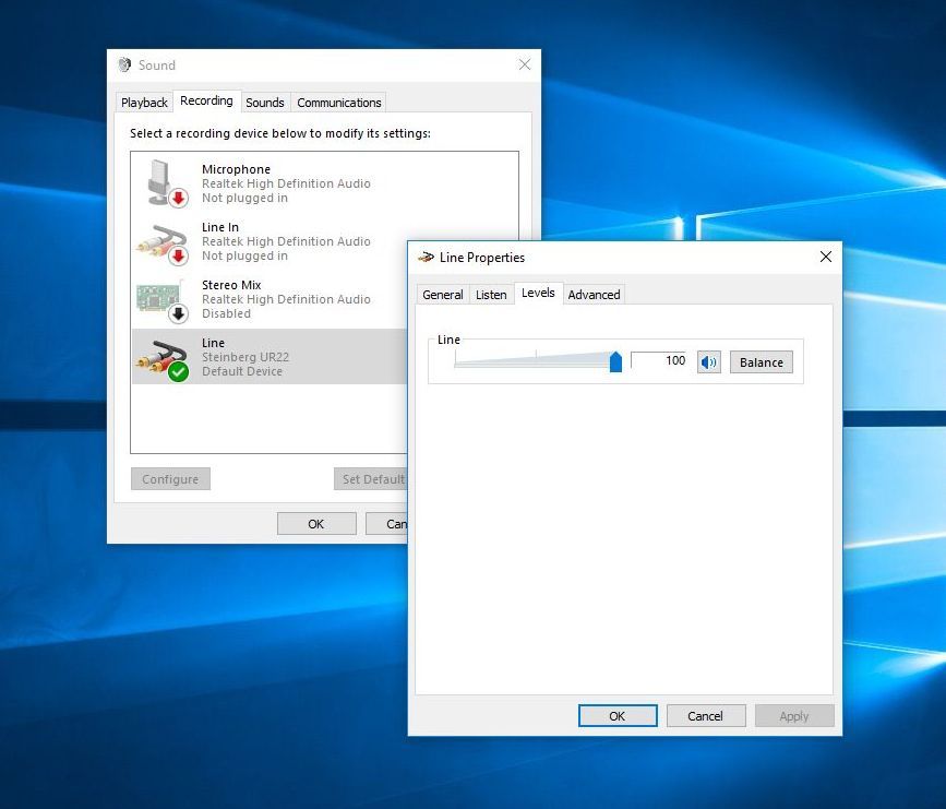

I have a steinberg UR22. If the other windows stuff can't be leveled back, maybe there is a way I could use the realtec outputs from the motherboard sent to different speakers?

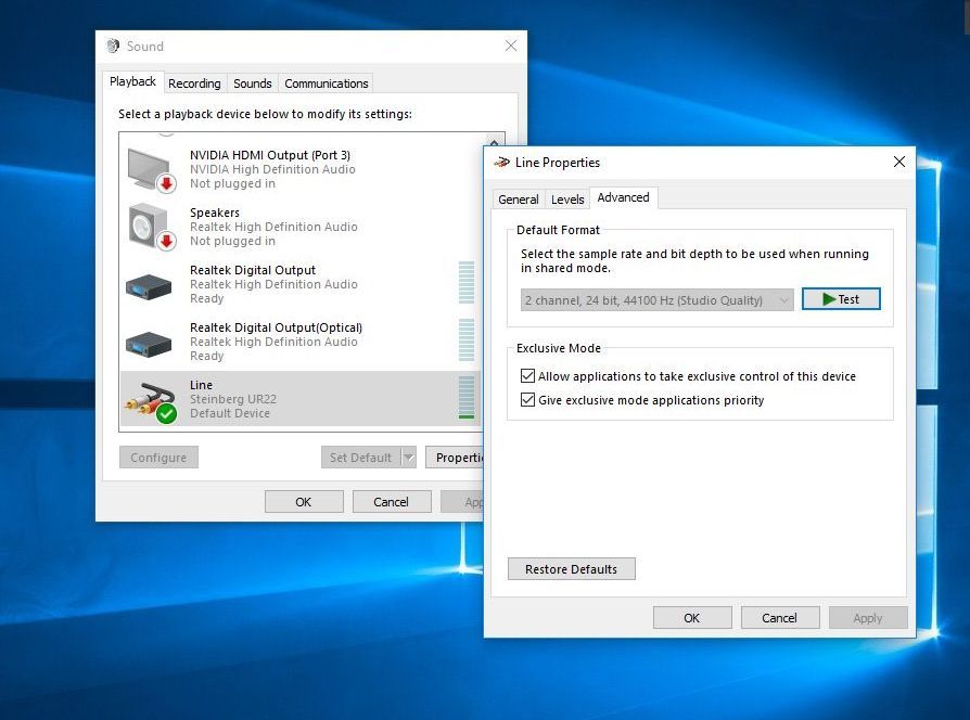

I messed up on the images, but the playback tab just has the one fader as well. Single output gain on the interface. It's probably all balanced in theory. But when I go from a solo violin sample and woodwinds, grab a coffee, decide to take a shower, then turn on an internet radio station that begins with a thunderous ad turned up to 11. Ok, user error.terrybritton wrote:You showed us the Recording levels, but what of the Playback section's Levels tab? That is the place where the level of Windows apps would be pulled down. The DAW should be sending via straight ASIO to the interface.
This sounds odd, because I have no such issue with any of my USB interfaces presenting volume strangeness. Is there a knob on the front of the Steinberg? (There is on several others that control output...)
