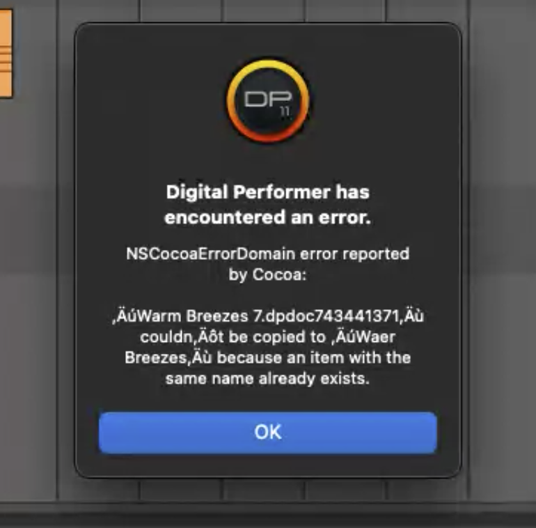

Need help for one of our team. Everytime they try to do a save on a regular old unlocked work in progress DP 11.32 file, they get the error below. I have seen them do this with my own eyeballs. The only workaround is to contiunuosly do 'save as'.
What does that error mean? Thanks!
Digital Performer error.png (214.06 KiB) Viewed 2003 times

The odd thing is that the name the error is flagging is not name of each file that fails for him. Whihc is all of them. Its adding weird characteers in the error which dont exist in the shown file name.

labman wrote: Tue Jul 23, 2024 9:01 am Need help for one of our team. Everytime they try to do a save on a regular old unlocked work in progress DP 11.32 file, they get the error below. I have seen them do this with my own eyeballs. The only workaround is to contiunuosly do 'save as'.
It happened to me yesterday. I think we found a bug.
A client sent me a number of tracks last night via WeTransfer for a session today. I created a Project and loaded them into DP, changing all the track names to match as I went along. When I went to Save. I saw the same thing. Yikes!
My first thought was that I had corrupt wav files (not my first rodeo on that issue) but, before I opened TwistedWave to convert them all, I tried the following: I closed the project and reopened—it was blank, of course. I added one track then Saved. I then changed the track name and Saved again. Next I added a few more Saving as I went along. No more issues nor when I added my bass track this morning.
A Cocoa message indicates a graphics engine error. Since I still have the original zip file, I will see if I can replicate this before I send it into MOTU via a Tech Link.
