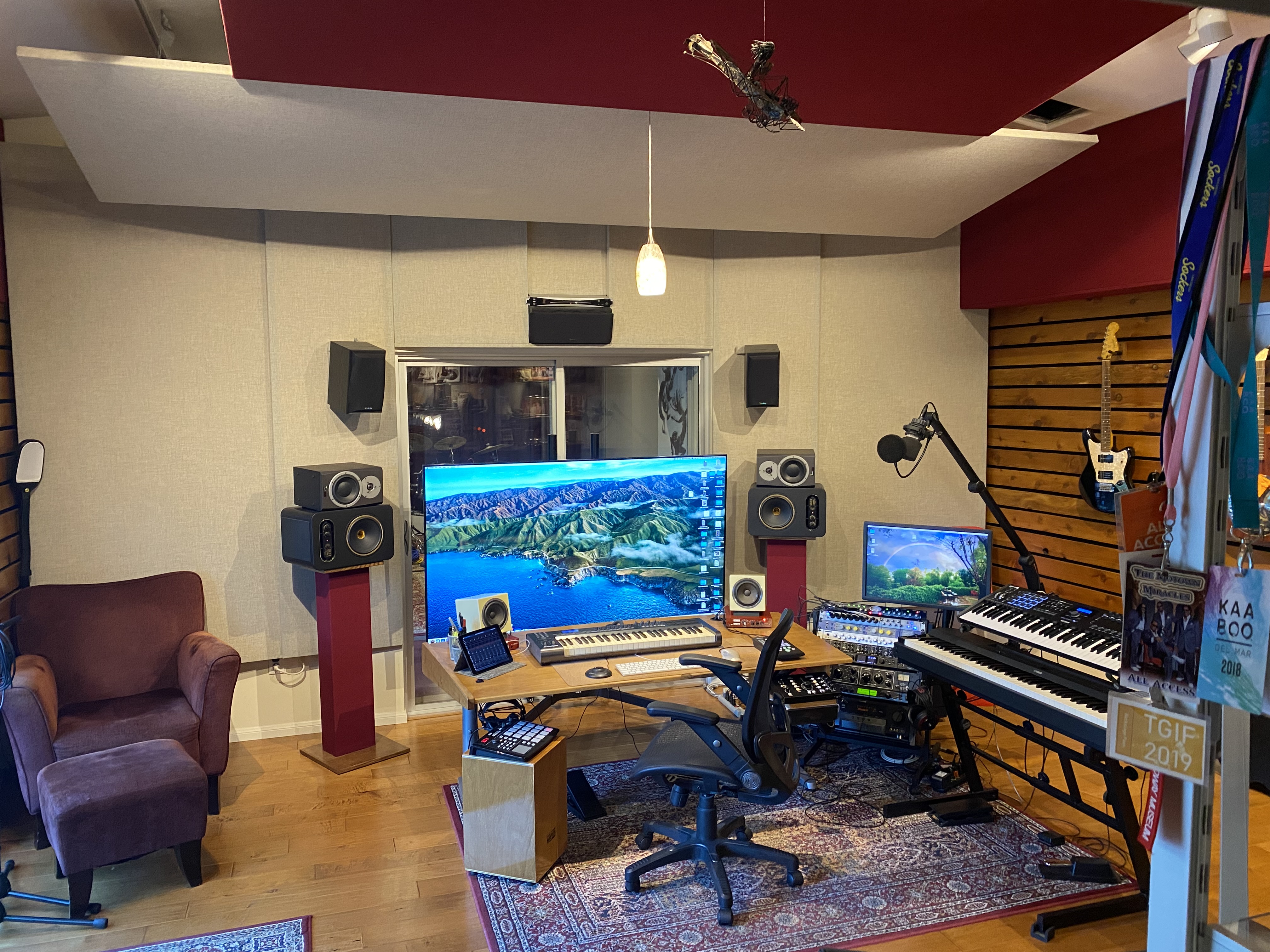

I just do what James said. Works nicely. Native HDMI on my Mac Studio drives a 75" TV, which I also use as my main display, but sure works fine when a client wants to see and hear. It is mounted on a stand that allows me to raise it higher when viewing picture. Second monitor is connected via USB C to Display Port adaptor.
