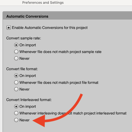

You are correct. Below is the pref. I ticked "never" and the deinterleaved files now import as a stereo soundbite, referencing the two mono files and not converting. This is helpful to me because I'm dealing with continuous tracks from a 75 minute show - so creating a new interleaved file from one track adds an almost 2 GB file to my audio files folder - wasted disk space.
I'm keeping that picture handy – I'll probably need it again! (Created by ChatGPT!).
import pref.jpg (71.19 KiB) Viewed 170 times
