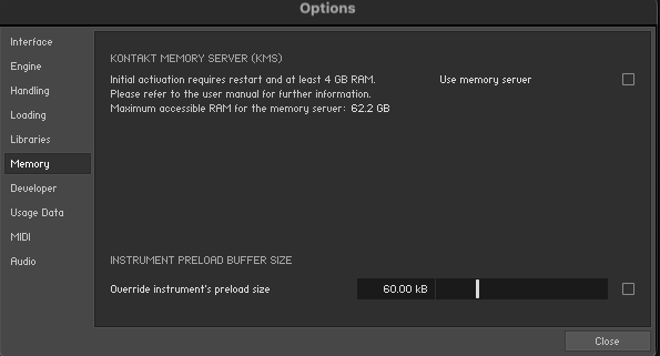

HCMarkus wrote: Sun Jul 07, 2024 6:45 am Reducing sample buffer ( pre-load) size in Kontakt and other VIs to minimum will shorten project load times and reduce RAM hit. Just don’t try this if you house your samples on spinning rust.
Been meaning to ask you... what settings are you using on Kontakt?

James Steele wrote: Sun Jul 07, 2024 1:47 pm
Minimum. All the way down. No issues with samples on NVMe SSD. NI says it is fine with even SATA SSDs.

Re: Digital Performer 11.32 loading times under Ventura 13.6.7
HCMarkus wrote: Sun Jul 07, 2024 3:10 pm
Thanks... I'll check my settings. Do you know if setting this in the standalone then applies it to when you launch as a plugin? I'll guess I'll just give it a shot right now and see where I have it set!
It was set to 60K which is the default:
I went ahead and dropped it to 6k. Be interesting to see if DP projects containing Kontakt load any faster. I needed to do this for a while I guess.
