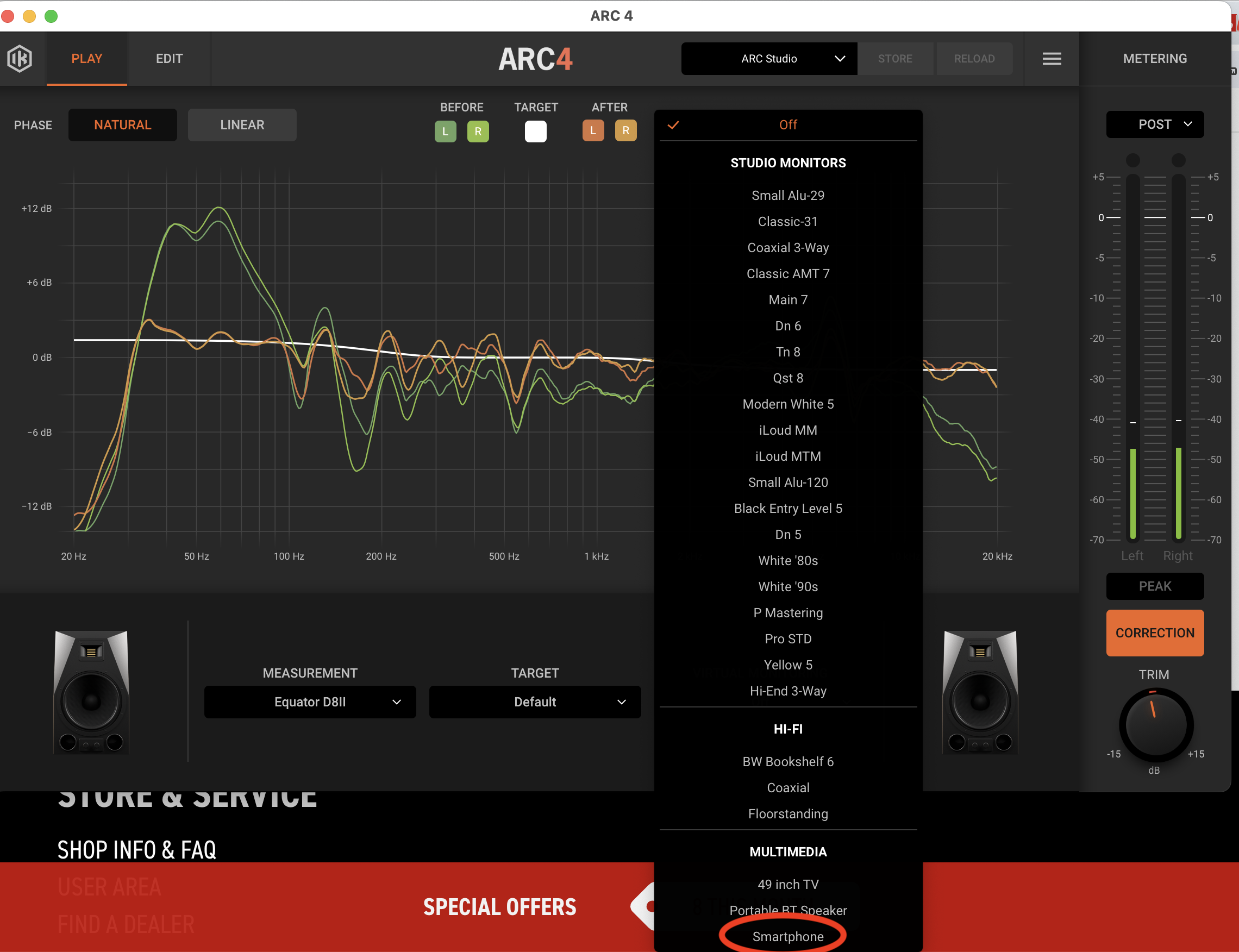

The attached graphic shows the Before (med and light green) and After (yellow/orange) against the ideal (white). This is done with the Sub disengaged. Anyway, notice how ARC 4 tamed a 12dB hump at 50Hz and flattened out a drop from 9K–20K. Both are notable improvements. Adding the Sub back in put it where I liked it (I'll explain later how I calibrate a Sub so that I can trust it).
Screenshot 2024-07-04 at 2.37.01 PM.png (467.26 KiB) Viewed 4142 times
Oh yea, this stays!
