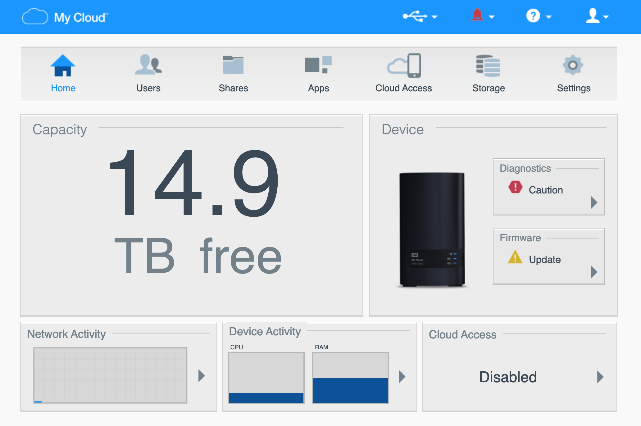

There's no software. There's firmware that is updated now and then. Everything is controlled through your web browser including setup, diagnostics, support etc. I keep the pages as permanent tabs.
I am not notified of updates so I click on the tab now and then. These screenshots are from a few minutes ago. The first shows a drive error and an available firmware update. I didn't run the diagnostics because I wanted to see if running the firmware update first to see if the error would go away. As you can see in the second picture, it did.
