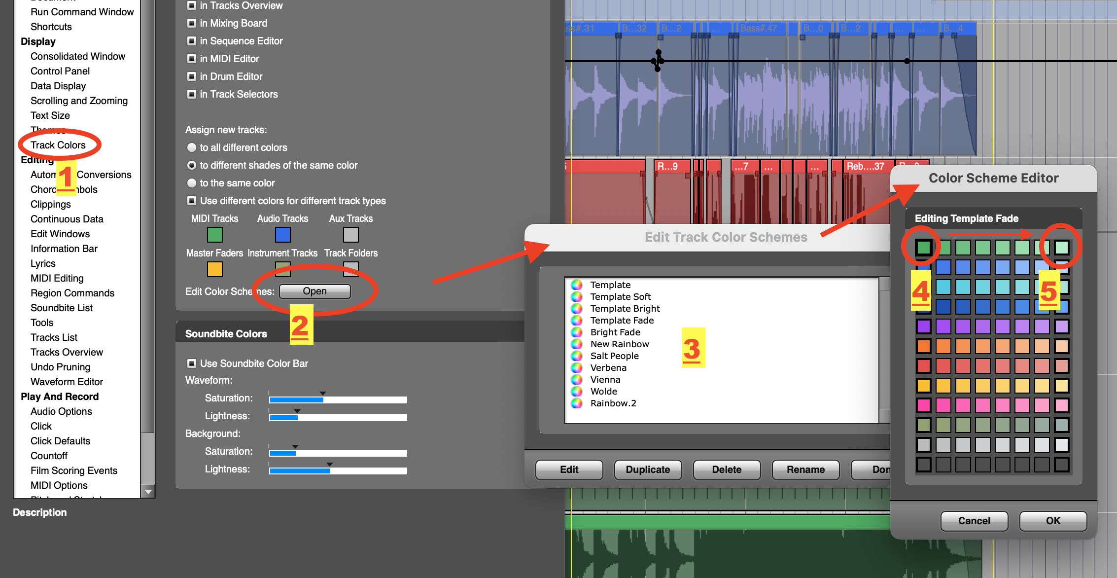

garyv
Posts: 1
Joined: Fri Apr 29, 2022 8:31 pm
Re: Track color SHADES not showing up in Tracks window
Post by garyv »
HERE's THE SOLUTION...
In the attached labeled screenshot:
  • Open the DP preferences and Select "Track Colors" (#1)
  • Open "Edit Color Schemes" (#2)
  • Double click to edit the color scheme (#3). Clicking on each will change your colors onscreen, so you can click 'til you find the one closest to the one you like or the "Theme" you're using.
    Don't be confused...
    "Schemes" are basic preset color sets MOTU gives you. "Themes" are presets (provided by MOTU or customized by you) containing a bunch of pre-configured settings and "Color Schemes". Sometimes the scheme just wasn't made with gradients, but they can all be modified.
NOW, here's where MOTU screwed up (aside from confusing us with "Themes" and "Schemes")... Themes without gradients aren't "broken" as we thought, there's simply no intuitive indication onscreen that the "Color Scheme Editor" is a modifiable gradient spectrum tool. This is where you can easily customize the "Scheme:"
  • Double-click on the first color box (#4) where you want the spectrum to begin and change it
  • Do the same with the 8th box (#5)
  • Click "OK," "Done," "OK..."
One last trick for the "spectrum" lines: You can actually drag the rightmost color box to the left (#5 to #4) or vice-versa to reverse the gradient order.
Screen Shot 2023-08-07 at 1.18.40 AM.png (635.92 KiB) Viewed 692 times
